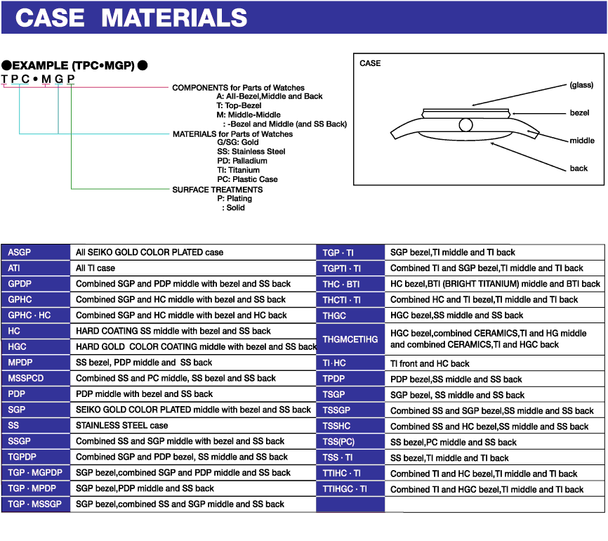

But things like SGP on a Seiko or CGP on a citizen generally don't mean real gold; rather Gold like or Gold colour plating.
This info can be found on charts outlining what the various letters mean on the case backs of these makers products. (as posted above).

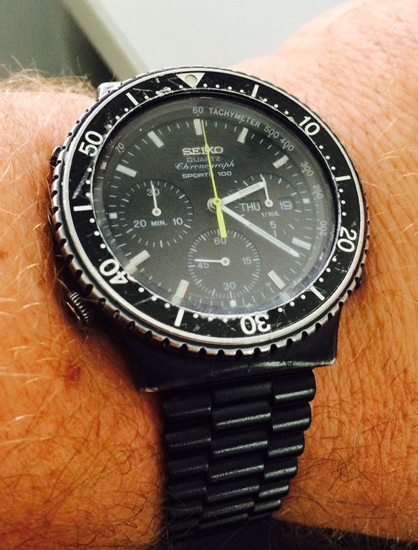

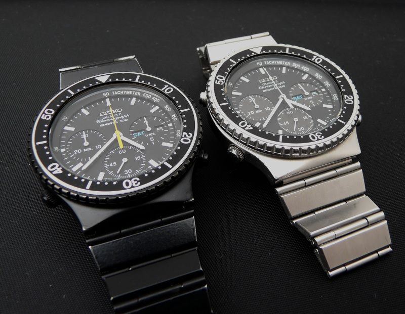

Something that has always intrigued me is the coatings they used on some of the 'Sports 100' 7A38's (and other 7Axx's).
I'm talking about the 7A38-704A/B/C and 7A38-7040 which (when new) had a matt dark grey outer coating, the 7A38-6020 with the mucky matt dark chocolate brown coating and of course all the matt black coated watches like 7A38-6010, 7A38-6030, 7A38-6070, 7A38-7080, 7A38-7100, 7A38-7140, 7A38-7180, 7A38-7290 and so on (excuse me if I missed a couple) ....
All of these watches have case-backs stamped either 'Base Metal' or 'BCRP' and if you call them up on Seiko Oceania's database they all show 'BCRP' in the case material field, without exception. Indeed, if you look at any well worn example of a dark grey 7A38-704x or a chocolate brown 7A38-6020 (I have examples of both, particularly the latter) you can clearly see the black chrome plating underneath.
My question is: What is the matt outer coating over the black chrome plating, that is so soft and VERY susceptible to rubbing wear ? :|
My belief is that it is nothing more than sprayed paint ! :o

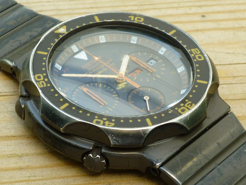

I did actually seriously consider re-spaying that first 'beater' 7A38-6020 I bought. I even went as far as to mix up some matching paint.
I wrote about my idea in this thread on RLT, dating back to November 2011 - to the obvious bemusement of some posters.
I was deadly serious at the time, but the following year I bought a much better almost pristine example, so I never got round to it. :roll:
I've since thought about re-spraying my 'beater' 7A38-704C too, particularly since I bought another almost mint example last year.
Nowadays, I generally tend to avoid any of these watches where the black chrome and / or the outer coating is badly worn.
However I will occasionally make exceptions. Last week, I bought a 'spares or repairs' 7A38-7080 in a job lot, with worn coating.
In this instance, I didn't care less about the worn outside condition of the watch. All I wanted it for was as a donor for its dial / movement and Tachymeter ring, which are now earmarked for another Franken project build. As it turned out, the movement needed rather more than 'possibly just a new battery', and took some titivation / persuasion to get it running again. But that's another story.
Regardless of whether I needed them or not, the case and bracelet got the usual overnight soak in neat Flash, followed by a gentle scrubbing with an old toothbrush under the tap and a quick spin in the ultrasonic cleaner treatment. The case came up quite well.
In fact, as I was drying them off, I pondered whether it might we worth attempting to re-spray them, or leave 'as is'.

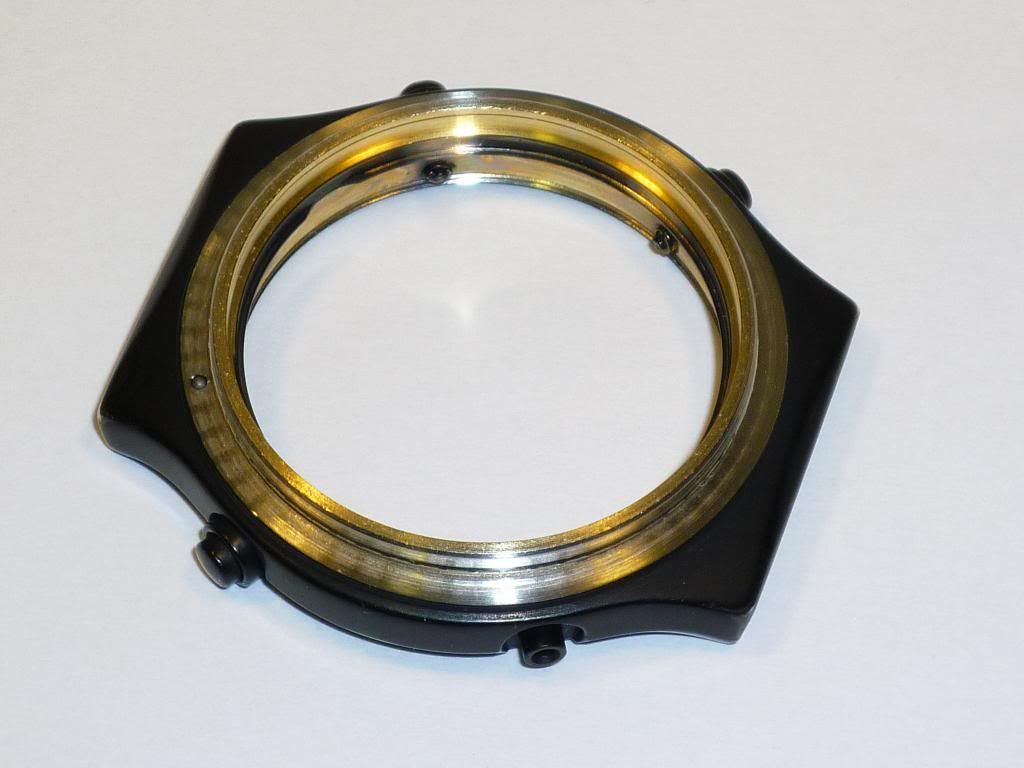

Anyway, to get back to my point, and on topic, what I noticed about the case was that not only was there clear evidence of over-spray on the inside and that although the bezel flange and track might have appeared 'stainless' the inside of the watch case was coated in gold-coloured passivate !
It doesn't show up particularly well in my first photo, but the colour is more evident in this one with the dial / movement fitted:

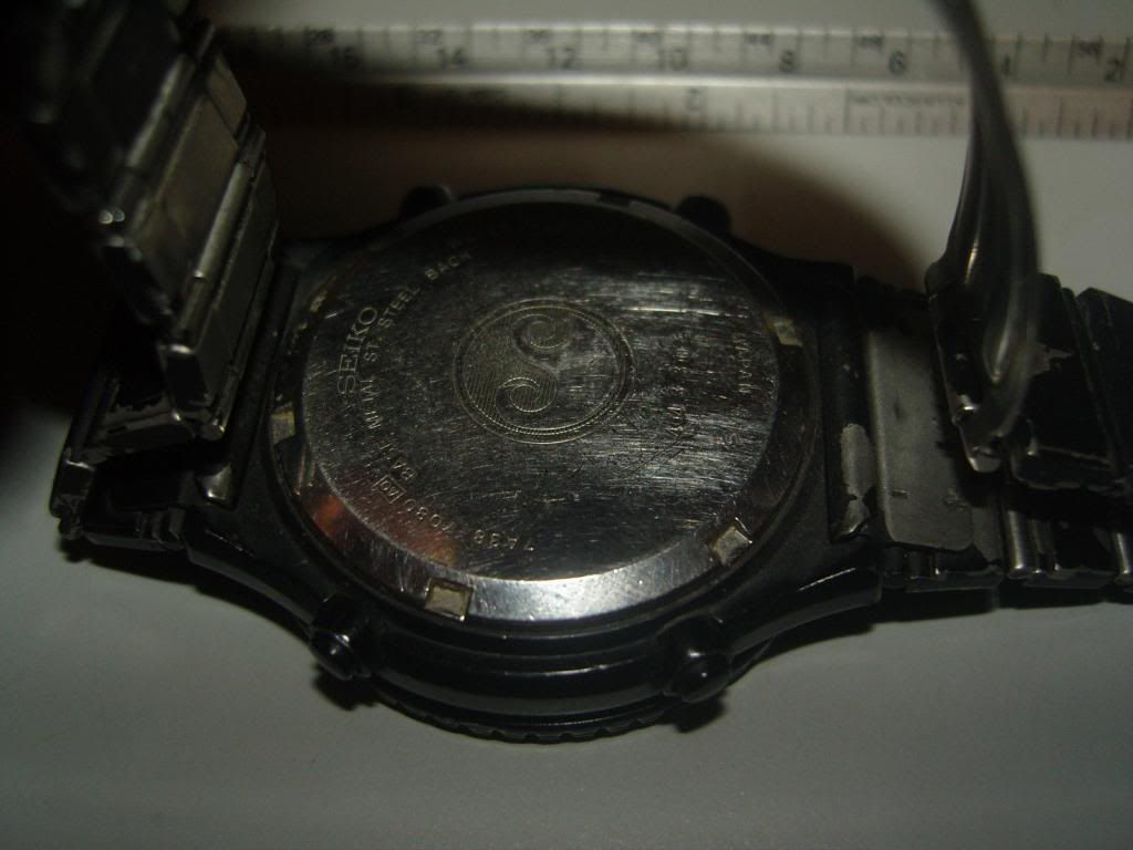

Which is where I made my little discovery. Recently, I'd bought another second 'beater' 7A38-7080 on eBay. It arrived yesterday.
The eBay seller's photos weren't particularly well lit, but they gave a good indication of the level of black coating loss:
March 27, 2014 at 3:19 PM Flag Quote & Reply
Overnight, I soaked the bracelet off the second one in neat Flash cleaning fluid. Before I did, it had already lost much more of its black coating, compared with the bracelet off the previous beater. But even more came off in the wash ! :o Here's some comparison photos.
Oddly the SQ-logo'd clasp closer on the bracelet which had lost much of its black coating shows far less signs of rubbing wear.
The significant difference is the bracelet that still has most of its coating is stamped just B1242, whereas the other is stamped B1242.P
I reckon 'P' stands for painted.  At the weekend I'll be digging my cans of paint stripper and cellulose thinners out of the garage.
