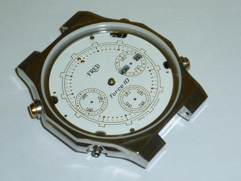

Amazingly, although a bit tight, it actually fitted ! :D
Problem is that when you flip it over, those six cut-outs around the perimeter are all too visible. :(
I was toying with the idea of filling them with small pieces of white plasticard, but ....
September 21, 2014 at 4:31 PM Flag Quote & Reply
Then I offered one of the Fred Force 10 dials up from underneath ....
So not only have I got six annoying little gaps around the perimeter of the Tachymetre ring, but a gap between that and the dial ! :mad:
The reason for the gap is just visible inside the case, through one of the dial cut-outs:
The small machined flange inside the watch case ! The Fred dial is one side of it and the brass Tachymetre ring on the other ....
and the way things stand at present, never the twain shall meet. So It looks like I'll be using the plastic Seiko Tachymeter ring. :/
Of more anon ....

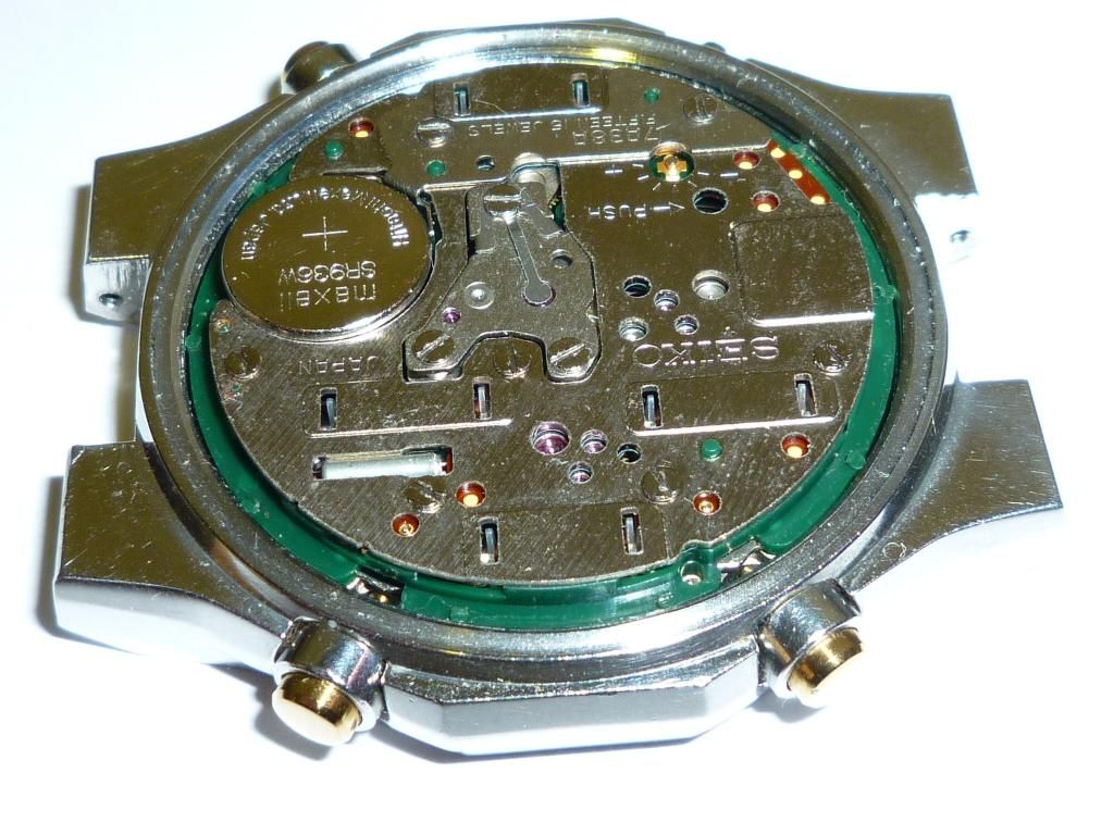

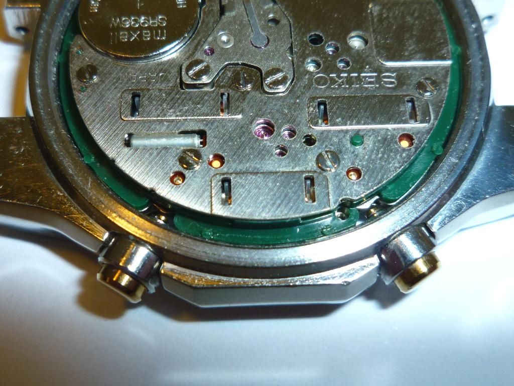

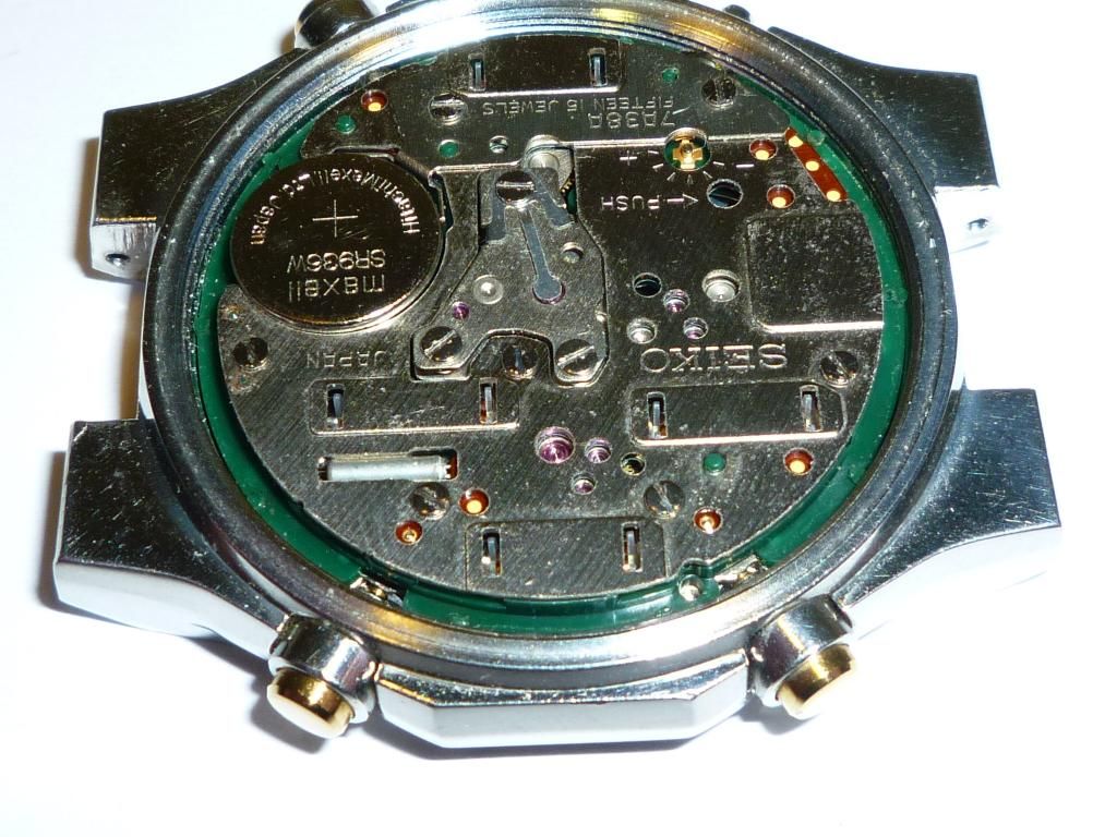

Of course, when I offered said Fred Force 10 dial with 7A38 movement up to the 7A38-7020 watch case, I had the same problem ....
That wasn't the half of it, though. Because when I flipped it over, not only was the movement protruding from the case slightly:
But, without even attempting to insert a crown stem, I had a major pusher shaft / switch actuator lever mis-alignment problem:
I really should have known what to expect, because I've been here before, four years ago, got the T-shirt and failed (in public) !
The mis-alignment problem is caused by the differences in dial construction and (double plate) thickness of the Fred Force 10 dial.
Or should I say a combination of different thicknesses and how they mate (or not) with the chosen watch case's dial mounting flange:

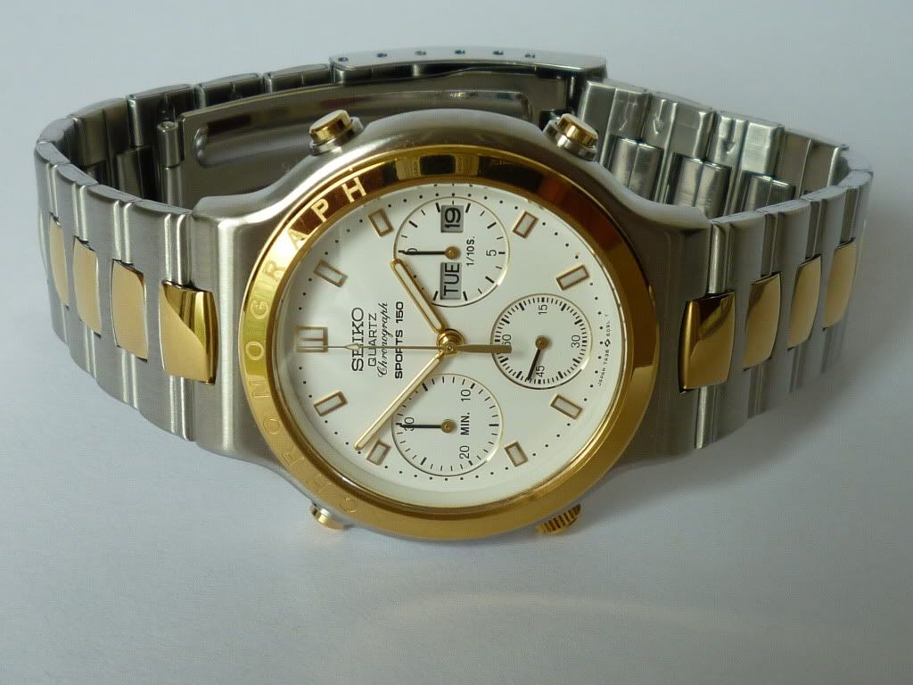

The way I got around the dial construction / thickness / chosen watch case problem 4 years ago was simply to abandon that project.
Well, not exactly.  Instead of fitting the 7A38-6109 609L sample case dial into a two-tone 7A38-7289 as I'd originally planned ....
I ended up building two Frankens - this one, which I posted in the WRUW thread recently and my 7A34 / 7A38 Franken

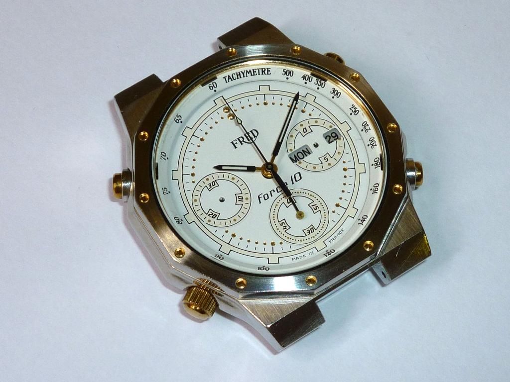

Nope. I decided I was going to stick with my original plan - and make it work this time. The solution was actually quite simple.
I needed to reduce the diameter of the Fred dial from 31.20mm to approximately 30.6mm, so it would fit inside the mounting flange.
So after scribing a line around the edge, using the inner diameter of the case flange as a template, that's exactly what I did.
September 28, 2014 at 5:13 PM Flag Quote & Reply
All I've done, by very carefully filing and sanding (by hand), was to take off a little over half a millimeter all the way around the dial.
That's just enough to allow the Fred dial to protrude through the 7A38-7020 case's dial mounting flange and instead sit flush with it:
Positive location is now provided by the movement spacer butting up against the underside of the watch case's (dial) mounting flange.
Flip it over and the previous pusher shaft / switch actuator lever mis-alignment problem is resolved:
With the bezel and Fred Tachymetre ring dropped in place - no more unsightly gap (at least not between the dial and ring, anyway).
Note the crown / stem now fitted to check correct alignment with the movement.

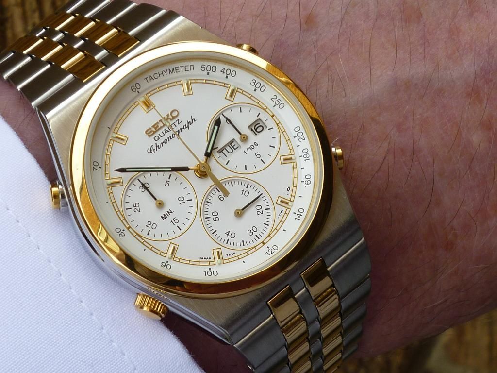

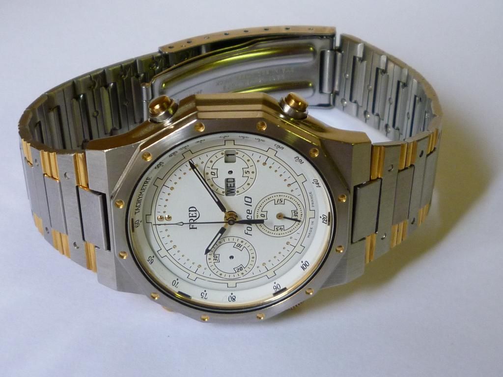

It lives.  Or at least this first iteration of the Fred Force 10 Franken does - for the time being, at least.
This morning I fitted a few hands to the prototype gash dial / movement. For want of anything better ....
I've used the hour, minute and sweep second hands from the original two-tone 7A38-7020 donor:
I'd studied that 1989 French magazine image of the original Fred Force 10 '7A38' and almost convinced myself that these three hands were stock 'parts bin' Seiko items. The sweep hand at least certainly looks very similar. However, they're not the same as these which I've used. For one thing these minute and sweep hands are slightly longer. As you can see from the above, the tip of the minute hand just slightly overlaps the outer outline of the dial motif - whereas on the original Fred Force 10, the tip is in the middle of it. Similarly, the lume pip on this Seiko sweep hand is closer to the two gold pips at '12'. But those aren't my biggest concern at this moment.
You'll notice that the two chrono' sub-dials are currently without hands - just one fitted to the constant seconds sub-dial. I'm not sure, at this stage what the Fred '7A38' actually uses for sub-dial hands. In that old magazine image they appear to be all black and have standard size bosses but disproportionately spindly pointers. Almost reminiscent of the sub-dial hands used on the YSL Yema N7.
I don't like them, personally, and seeing as this is a Franken-watch anyway, I decided to do my own thing - gold bosses (to match the dial pips) and black pointers. So naturally you might have expected I would have used the three p/n 04E14AL hands off the two-tone 7A38-7020. Can't - they're too long. The Fred sub-dials are smaller diameter than most 7A38's. So the one shorter hand I've got fitted at the moment is a p/n 03E12XG off a 7A38-6109 sample case dial. The 7A38-6109's constant seconds sub-dial is smaller in diameter than the other two (which incidentally also use p/n 04E14AL hands). The only other 7Axx which uses these particular shorter sub-dial hands is the two-tone 7A38-6080. Cousins don't list them but Seiko Australia show them as in stock.
I may yet re-think the hands altogether and 'bling it up' a bit - and go for an entirely different all gold-plated handset. Let's see.

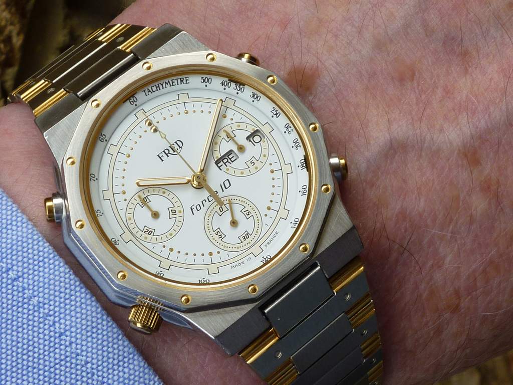

Here's a possibly slightly better Q&D wrist shot of the first fumbled Franken Fred prototype, I rattled off in the early morning sunlight.
October 10, 2014 at 5:13 AM Flag Quote & Reply
It's by no means finished yet - even in this first incarnation. But I should explain - I've been working to a self-imposed deadline.
When I started this topic a little over two weeks ago, I had a silly idea. :P I haven't posted this particular photo in the thread before ....
Had I been building the Fred dial into a Yema / C.G.H. case (as indeed I may well do with the next prototype), I would have utilised a Shimauchi V906 branded movement naturellement - with a French / English day wheel - presumably as per the original Fred Force 10.
As it happened, the two-tone 7A38-7020 which in effect became the donor watch for the project had a German / English day wheel.
The German abbreviation for Friday / Freitag being FRE(d) and Friday the 10th only comes round a couple of times in any year. :D
Yesterday, I fitted the second, better condition (now reduced diameter) Fred dial, in an effort to get the watch finished by my deadline.
The Seiko p/n 03E12XG sub-dial hands I'd ordered via Smith & Smith still hadn't arrived. But I'd put a contigency plan of sorts in place. I'd sussed out a possible alternative - p/n 03E30HG, (the constant seconds sub hand used a two-tone 7T32-6A50, etc.) and ordered those from Cousins last week. I'm not sure what the 7T32 hand hole size is, but they really didn't want to fit on the 7A38 hand spigots.
With a bit of careful reaming and gentle persuasion eventually they did - after a fashion !
Readers who are familiar with my personal modding preferences may be wondering why I elected to use a Seiko clear nylon crystal gasket, instead of a Sternkreuz white nylon one, which I sometimes use with white dials / rings. It wasn't through choice. Last week, when I ordered the Seiko p/n 310P03HB0A crystal from Cousins, I'd also ordered a Sternkreuz p/n IG318310H intended to fit it with.
They supplied the wrong part. :mad: What I actually received was a p/n IG318311 (without suffix), which is only 0.8mm high - not 1.2mm.
So now I've got to go through Cousins' b*llsh*t returns procedure once again, to prove their mistake and get a correct replacement. :roll:
Those couple of issues, which will be rectified in due course, apart ....
I've still got a slight problem with the alignment of this Fred dial and Tachymetre ring, which is approx. one degree out (clockwise).
Obviously I've still got the issue with the six cut-outs visible around the Fred Tachymeter ring. I may yet try the Seiko one in there.
The 7A38-7020 donor watch case is still 'as was' and needs re-finishing, to the same standard as I've already done the bezel.
I may also try fitting a set of gold plated hour and minute hands and another different bracelet in place of the Seiko p/n Z1005C ....
