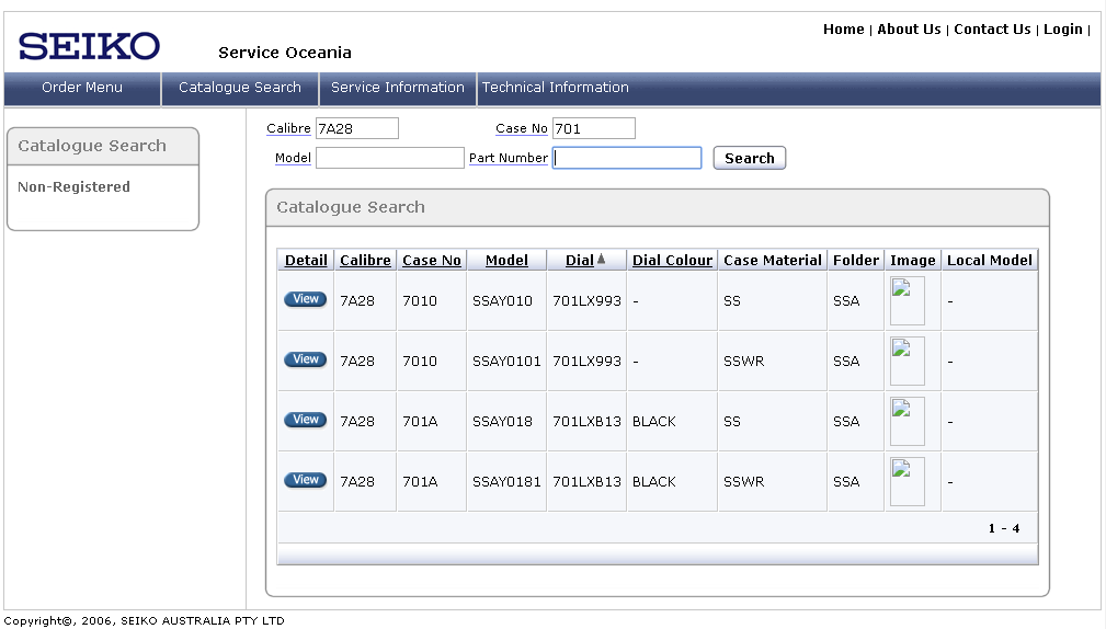

Hello, Phil. I don't mind helping newbies with parts enquiries, but you could have quite easily found the answers and the parts yourself - with very little effort. It takes me far longer to write up a reply like this than it does to actually find the information.
First of all you need identify the part numbers.
Use Seiko Oceania's database search: http://service.seiko.com.au/pls/seiko/f?p=104:20:4430620842388987:Go:NO:RP::

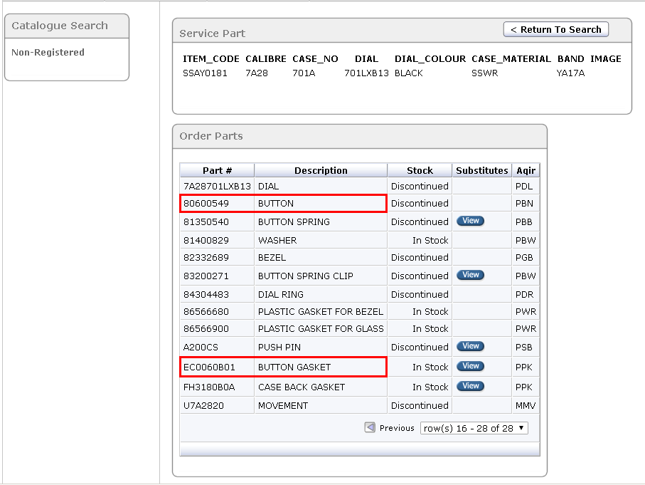

These Pushers (Button) and O-Ring Gaskets are common to the 7A28-7010 and 7A28-701A - which presumably you already knew.

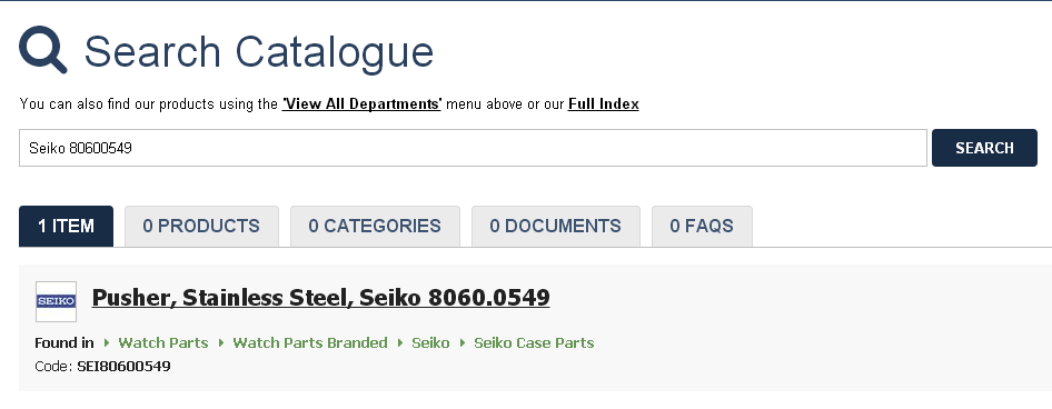

The same pusher button p/n 80600549 is also used on various 5M22 and 5M42 Kinetics (one only) and the 7T27-7A10 (2 only).

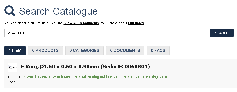

The same pusher gasket p/n EC0060B01 is used many other 7A28's and 7A38's and hundreds of other Seiko chrono' models.

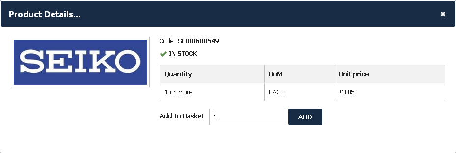

Go to Cousins UK and search on both part numbers:
http://www.cousinsuk.com/search?SearchTerm=Seiko+80600549

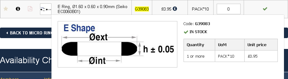

http://www.cousinsuk.com/search?SearchTerm=Seiko+EC0060B01
This is a substitute part number (rather than OEM Seiko). I've never tried these before myself (I've been using Labanda O-Rings).
A lot cheaper though. :)
