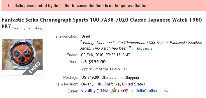

Couldn't quite believe my eyes this morning, when I first clapped eyes on it.

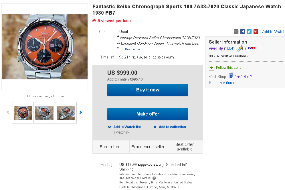

http://www.ebay.co.uk/itm/262255454819
Vivid indeed !!  It's certainly 'One of a Kind' - and not one I'll forget in a hurry !

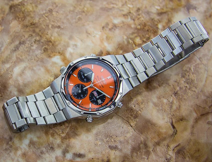

But forgetting, for the moment, the garish orange dial - and ignoring the seller's utterly bnllsh!t description of the watch ....

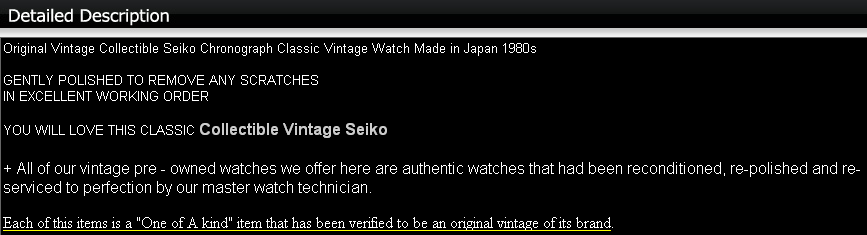

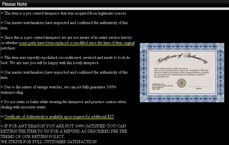

Replete with multiple false claims of authenticity, verified by a master watchmaker (presumably a partially sighted or retarded one) ....

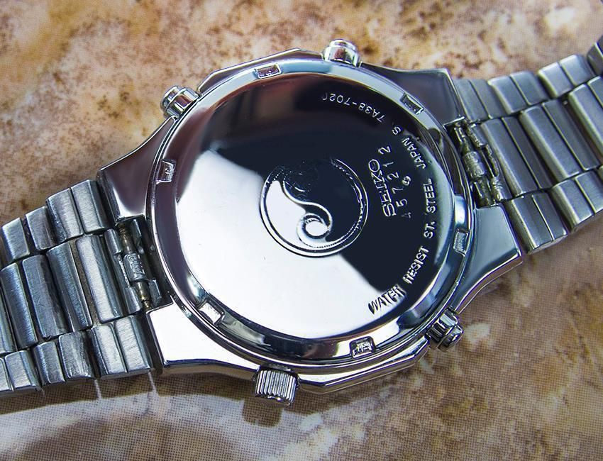

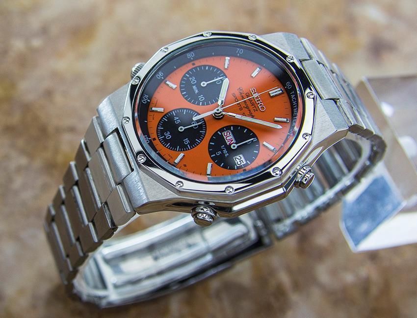

What we are actually looking at is one very tired example of a stainless 7A38-7020 SAA009J that has been heavily re-brushed and over-polished. The amount of stretch present in the bracelet links gives a good indication how well worn this watch was to start with.

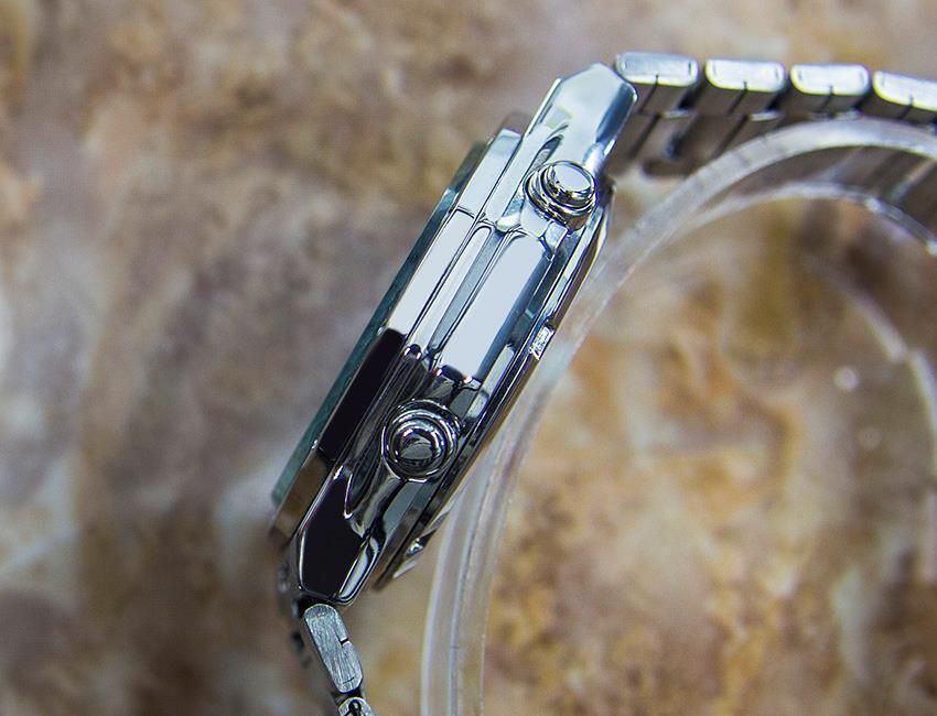

The grossly over-polished bezel isn't quite properly aligned with the watch case. It's also been fitted with a replacement crystal - thicker than the original 1.6mm, with a large polished bevelled edge, which is what's causing that distortion around the Tachymeter scale.

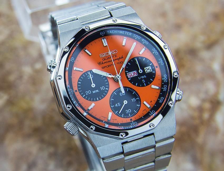

Apart from the gaudy colour, note also that the dial's scabby-looking hour batons and 3, 6 and 9 marks are devoid of lume pips.
Even the bosses of the hour and minute hands have been over-polished - removing too much of their original white paint. :roll:
January 23, 2016 at 6:46 AM Flag Quote & Reply
The $64 question is: How did they achieve that garish orange dial with black printing (and black sub-dials) ?
The dial has the correct (partial) 703L part number to the left of the 5 o'clock baton (which you'd expect to find on all 7A38-702X's) ....
but here's the Taupe coloured 703LX99L dial (black sub-dials) you'd normally find in a stainless 7A38-7020 - with white printing !

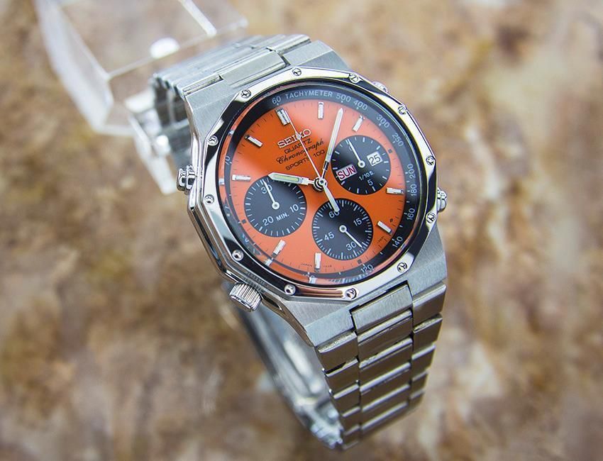

January 23, 2016 at 7:09 AM Flag Quote & Reply
If it's a (complete) re-paint it's a very good re-paint.
I suspect however, that it's more likely a re-paint of the light grey upper plate of 703LXN18 dial (as used in a two-tone 7A38-7020) ....
or possibly of the gold upper plate of the 703LXG18 dial (as used in the two-tone 7A38-702A/H) - both of which have black printing.
Then with their dial plates split - and re-using the lower black sub-dial plate from the original stainless 7A38-7020 703LX99L dial.
Pretty much as I did with my 7A38-7020 Franken, a few years back (except they've used the stainless batons, rather than gold plated):
But instead of leaving the upper plate in a standard (albeit slightly faded) Seiko colour, they've sprayed it with clear orange lacquer.

This US eBay seller VividLily certainly seems to have a thing about orange (and other non-original brightly coloured) dials. :roll:
I had a quick scroll through their other current listings and found these - all with dials of suspiciously similar hues of orange:
http://www.ebay.co.uk/itm/Mens-Vintage-1950s-Rolex-Tudor-Solid-9K-Gold-Mens-Luxurious-Dress-Watch-EB139-/252263298260
http://www.ebay.co.uk/itm/Seiko-Champion-Calendar-860-Made-in-Japan-Vintage-Mens-Manual-Watch-c1960-PB24-/252260290114
http://www.ebay.co.uk/itm/Rare-Swiss-Made-Rado-Montana-Automatic-Vintage-Watch-For-Men-c1970-PB28EB122-/272107816624
http://www.ebay.co.uk/itm/Gorgous-Citizen-7-Automatic-Retro-Style-Vintage-Watch-Made-in-Japan-c1960-FFR34-/252254358778
http://www.ebay.co.uk/itm/Bulova-1970s-Swiss-Automatic-Ref-N3-Stainless-Steel-Mens-Retro-Watch-D132-/272101737171
http://www.ebay.co.uk/itm/MENS-RARE-RADO-MANHATTAN-MADE-SWITZERLAND-AUTOMATIC-CIRCA-1968-D11-/262229419205
http://www.ebay.co.uk/itm/Seiko-Gyro-Marvel-Automatic-Rare-Japanese-Collectible-Watch-1960s-for-men-L137-/252227930405
http://www.ebay.co.uk/itm/Collectible-Citizen-Auto-Dater-Uni-Japanese-Mens-Automatic-Dress-Watch-D109-/272087341290
http://www.ebay.co.uk/itm/Collectible-Titoni-Swiss-Made-Vintage-Manual-Mens-Rare-Dress-Watch-Circa-L173-/272087333193
http://www.ebay.co.uk/itm/Very-Rare-Beautiful-Longines-Swiss-Made-Ladies-Dress-Watch-Circa-1970s-NR47-/262209790917
http://www.ebay.co.uk/itm/Beautiful-Swiss-Girard-Perrgaux-Vintage-Dress-Watch-for-Women-Circa-1950s-NR48-/272087270328
http://www.ebay.co.uk/itm/Seiko-6139-6040-Chronograph-Japanese-Collectible-Original-Classic-Watch-L166-/272087268420
http://www.ebay.co.uk/itm/Very-Rare-Bulova-Automatic-Swiss-Made-Vintage-1970s-Mens-Dress-Watch-L133-/272085628564
All are variously described as 'Restored' and 'Authentic'  - and that was just in the first 5 pages !! :o

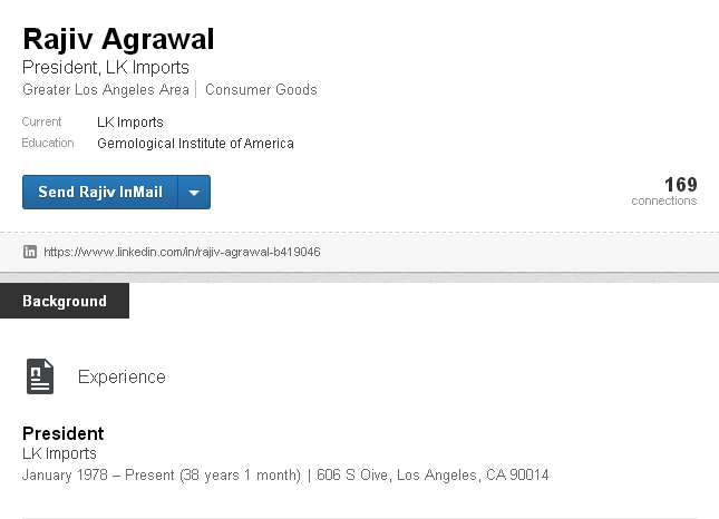

This orange dialed 7A38-7020 may have been the reason why VividLily first came up on my personal radar, but it's clear that this is a well established large scale operation. They've been selling on eBay since June 2010 and currently have over 2000 items (mostly watches and equally garish rings) listed and a feedback rating of over 10,800*. So I decided to do a bit of online detective work.
There's a clue to their identity provided in the link in my previous post. Further down you'll find documented eBay correspondence between the complainant and seller, dating back to May 2014. The seller's eBay ID at that time was not VividLily but LimcorInc.
Indeed you can see they changed their eBay ID in June 2014 (possibly as the result of this complaint, or other negative feedback):
http://contact.ebay.co.uk/ws/eBayISAPI.dll?ReturnUserIdHistory&requested=vividlily
Once you've made the Limcor Inc. connection, it's not difficult to track down their associated companies:
The registered proprietor of all three being one Rajiv Agrawal - a name of Asian Indian origin. As borne out by his Linkedin profile:
*Of that 10,800 Feedback rating 4000+ can probably be accounted for by their sales of Tunsgsten Carbide wedding rings @ $17.99 !
January 24, 2016 at 6:01 AM Flag Quote & Reply
So where am I headed with this, you may well be asking yourself ? :|
Although the Item Location of this watch (and many others) is stated as Beverly Hills, California, United States, the shipping part of the description states 'Our packages are shipped right to your door from our offices in Los Angeles, CALIFORNIA'.
The registered offices of Limcor Inc. (and other associated companies) are 12 miles away from Beverly Hills in Downtown LA.
See: http://www.loopnet.com/Listing/18904247/606-S-Olive-Street-Los-Angeles-CA/ - and this current office lease listing
Although Limcor Inc. rent an office suite in 606 South Olive Street, LA, I suspect this may be something of 'a shop front'.
Note that one of the associated companies also owned by Rajiv Agrawal, LK Imports shares the same registered address.
And where's he likely importing these watches from ? I'll give you one guess - India. Home of the garishly re-painted watch dial.
Whereas it's not a direct reference to watches, but the other part of his business - diamond rings, I found this on QJM's website:
http://www.qjmcorp.com/aboutus.htm
QJM Corp. was formed in 1994 by Rajiv Agrawal and Meenu Agrawal. Rajiv and Meenu are the owners of L.K. Imports, a highly respected diamond importer based in Los Angeles with buying offices in Bombay. (Bombay was re-named Mumbai in 1995).

The 'C' in Chronograph and '1' in Sports 100 both appear to indicate that the artwork is slightly off - so I'd probably agree that it's a redial. I'd like to know who they used though - the quality and crispness of the print is pretty incredible compared to most dial refinishing companies!

This patently less-than-forthright eBay seller VividLily clearly has no qualms about resorting to other dubious under-handed tactics to draw attention to their over-polished re-painted wares.
On 1st February, the quantity of these 'One of a Kind' 7A38-7020(s) was mysteriously reduced back to one again.
http://cgi.ebay.co.uk/ws/eBayISAPI.dll?ViewItemRevisionDetails&item=262255454819
Then yesterday evening, the 30-day listing was ended early because the item was allegedly no longer available:

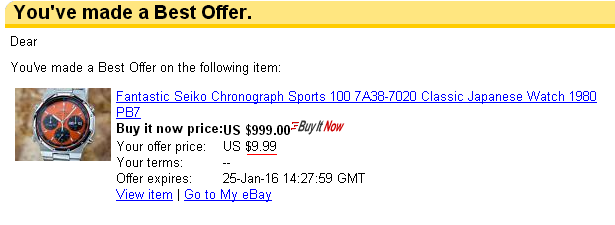

There were actually only 3 offers made against the 7A38-7020: one for $99; another for $20 and my '1% lowball' for $9.99 ! :lol:
