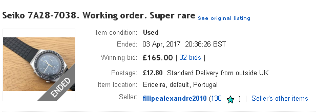

Luckily for you, I remembered seeing this comment that you'd left on your own profile:
It wasn't too difficult to find the recent eBay listing where I presume you bought this watch:
http://www.ebay.co.uk/itm/Seiko-7A28-7038-Working-order-Super-rare-/172597114052
It is indeed 'super rare', because there's no such thing as a 7A28-7038. That model number / suffix doesn't exist. :roll:
Look closely at the model number stamping on your watch's case-back and you'll see that it's actually 7A28-703B.
In fact, if you look again at the eBay seller's description, you'll see he subsequently added an amendment to it:
The 7A28-703B and US market 7A28-7039 have black dials with silver sub-dials, as you correctly stated (in a roundabout way).
I'm sorry to tell you, but the watch you have purchased is a complete Franken - cobbled together from two (or maybe 3) watches.
The very dark blue 703L and orange sweep second hand are from a 7A28-703A (similar model with a Pepsi bezel).
Google images and you'll see what I mean. :/
If you want to try and locate a replacement minute ring, the Seiko p/n for the 7A28-703A is 84304304 and the 7A28-703B / -7039's is 84304305. Both are listed as 'Discontinued', so I wish you luck in finding them.
Same applies to the bracelet(s): p/n B1073S for 7A28-703A and p/n B1074S for the 7A28-703B / -7039.
Personally, I wouldn't bother trying to restore it and recommend you chalk it up to experience. :(
You could try negotiating a partial refund. Either that or return it to the seller for a full refund - I think you'd be within your rights.
