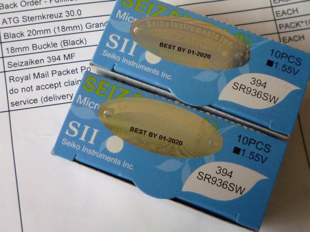

Originally posted by myself on August 1, 2014 at 1:00 PM:
From August, Cousins UK have announced that they will be stocking Seizaiken batteries, made by Seiko Instruments:
http://www.cousinsuk.com/catalog/batteries/seizaiken-watch-batteries/seizaiken-3xx
More data here: http://www.sii.co.jp/en/me/datasheets/silver-oxide/seizaiken/  .... Guess what I'll be ordering next time ? ;)
Well it took a while to finish off my existing stock of Renata #394's but that's what I just did - yesterday:
Note the Seizaiken boxes come with a hologram sticker and a reassuring 'Best Before' date stamp. :)

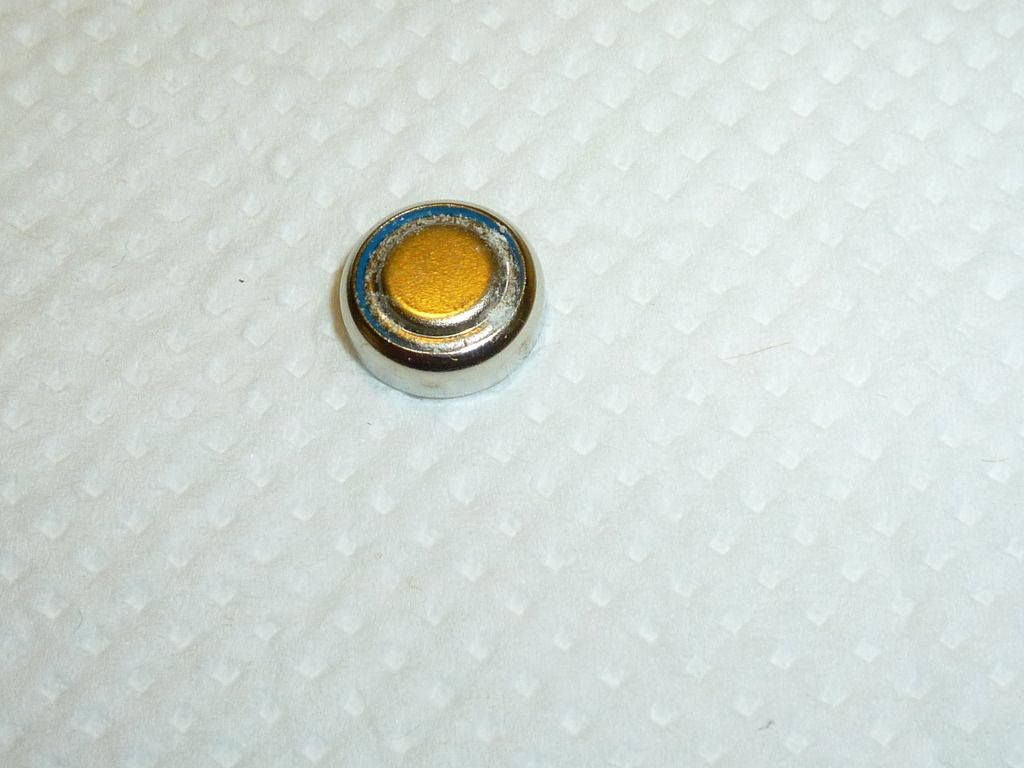

I've criticized Rayovac batteries before (at the beginning of this thread). I bought a 7A38-7120 last weekend. It arrived yesterday, working, but doing the two-second two-step (low battery indicator). I decided to fit a new battery this morning, rather than let it expire. Just as well. The Rayovac #394 fitted had already started to spill its guts - while the watch was still running. There were plenty of little white flakes in the battery well that needed cleaning out - and more weeping out of the battery. Unfortunately I fumbled the battery and dropped it, as I tried to turn it over, so most of them fell off. But you get the picture ....
