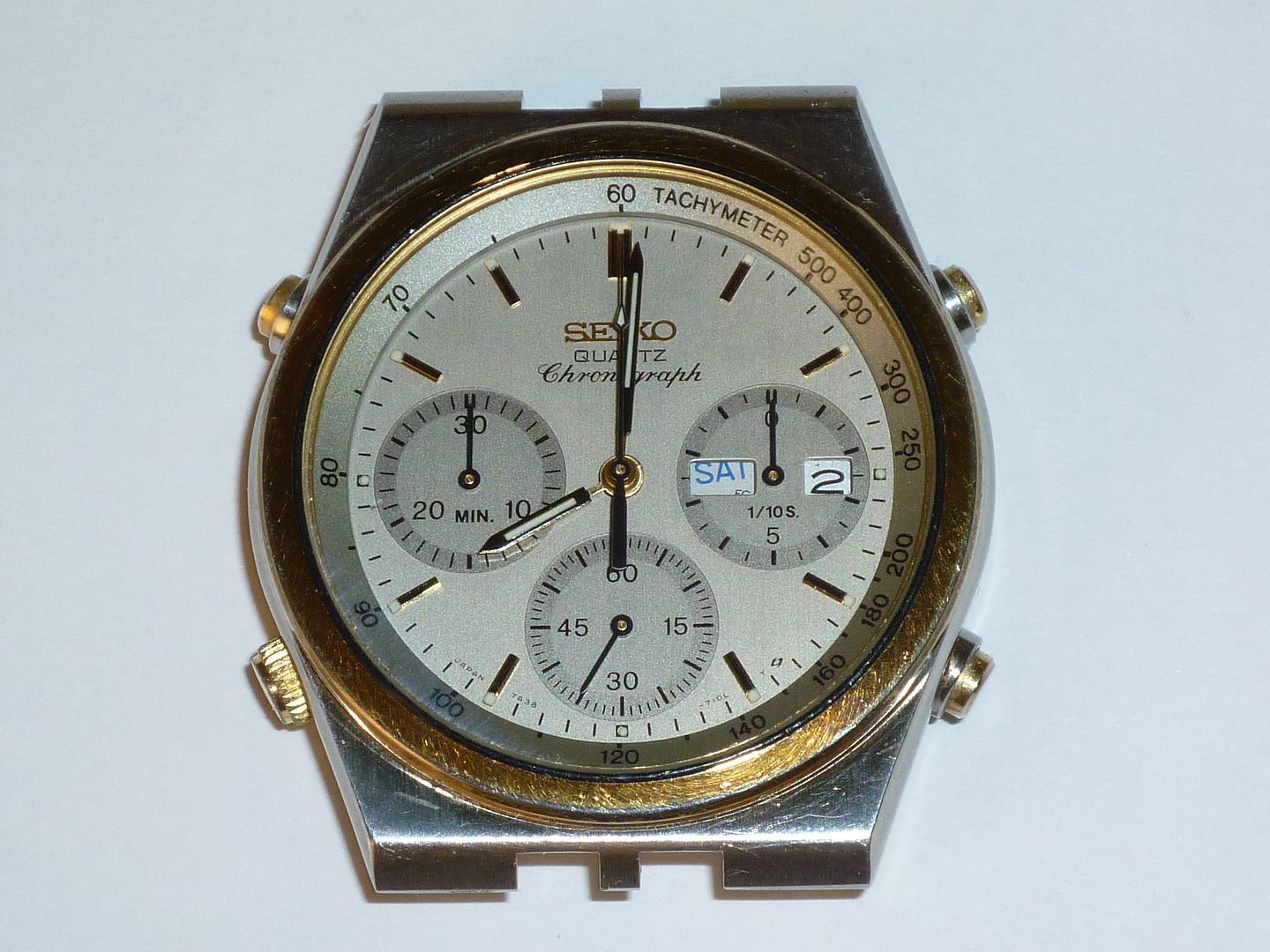

A pretty basic question really - and one I'd expected might have been asked in this thread in the main 7Axx General Discussion area:
seiko7a38.com/apps/forums/topics/show/8474319-everything-you-always-wanted-to-know-about-seiko-7axx-s-but-were-afraid-to-ask-
But if you don't have a copy of the Seiko 7A38 instruction manual and haven't managed to find an online .pdf version ....
http://www.Seiko7A38.com/Seiko7A38-UserManual-Scan.pdf (a link is included on our 'Other Links' page) .... You might well ask.
This morning, with my 'Admin' hat on, I ran my usual daily check on incoming google searches - and noticed this one in particular:
how to set day date on seiko 7a38 Try it yourself: Google search (Belated edit: this topic is now the first result returned).
The visitor from Larbert in Scotland certainly had a good look around the forum, but I'm not convinced he found the answer he sought.

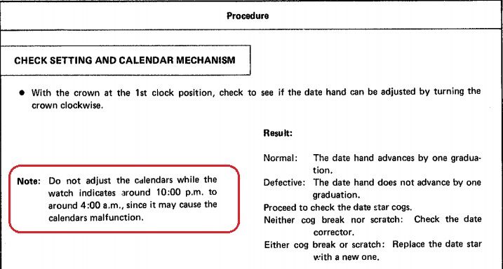

It is of course on page 4 of the Seiko 7A38 instruction manual (and hopefully common knowledge to everyone on this forum):
January 24, 2013 at 10:13 AM Flag Quote & Reply
However, the 'Note' at the bottom of the page should probably include a stronger warning:
Rather than merely stating: 'the calendar will not change to the next date' ....
Perhaps it ought to read: the auto day change-over might never work again !
You can of course change the day / date (as on any watch) by advancing the hands through 24 hours (or more) by turning the crown.
But the Seiko 7A38 has a 'quickset' day / date feature - as shown on page 4 of the instruction manual. It's one of the more modern features that those of us who love these watches appreciate. It is also the watch's Achilles Heel. If you read on the 'Net elsewhere about Seiko 7Axx's, you'll sometimes see the phrase 'All Metal Gear Train' touted. I've used it myself in eBay listing descriptions.

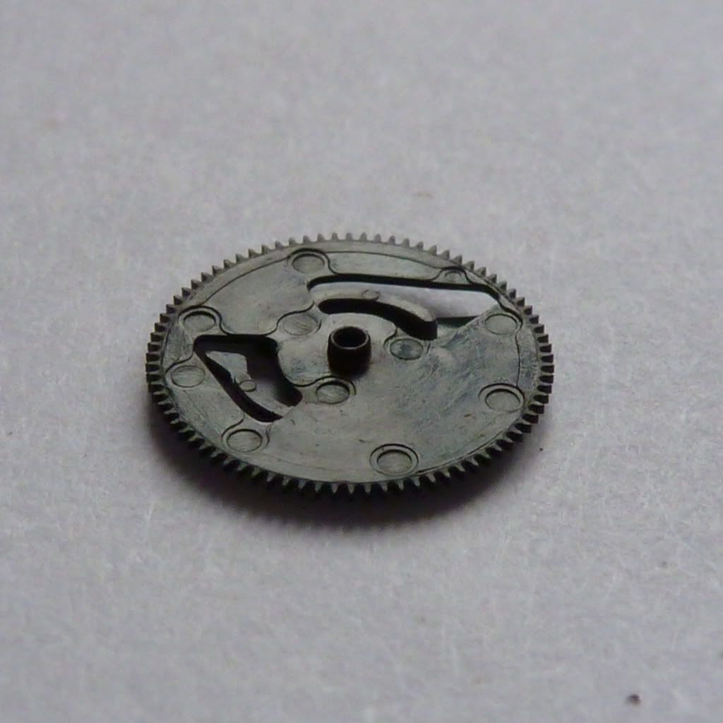

It's not strictly true. There is one plastic gear in a 7A38 - the Day / Date driving wheel (Seiko part  # 867.725). It is the weakest link.
January 24, 2013 at 11:26 AM Flag Quote & Reply

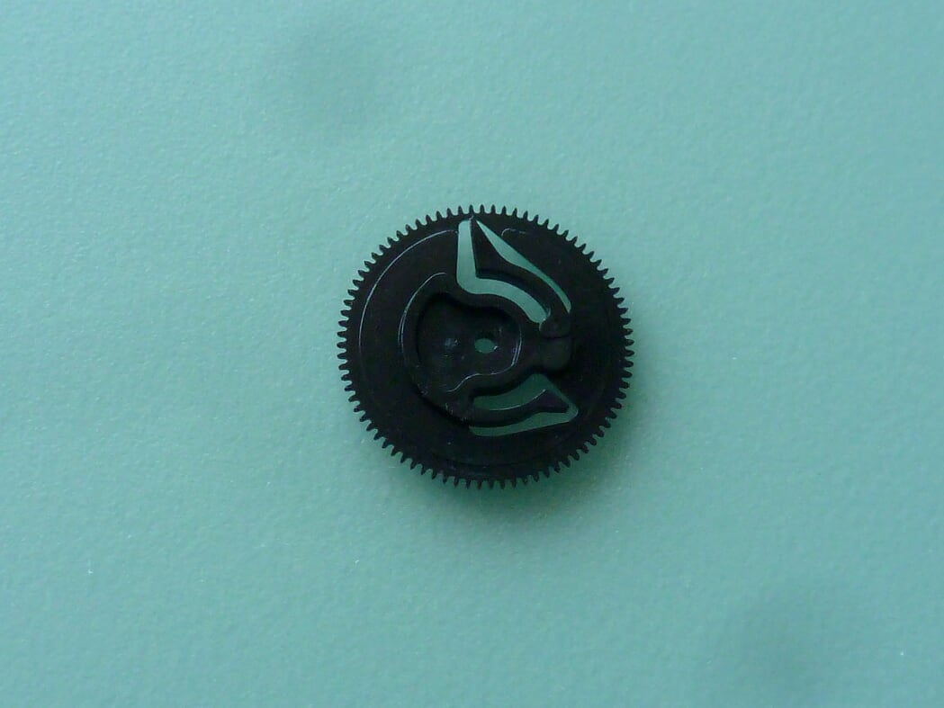

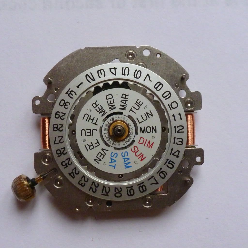

Here's a few of Simon's photos, showing the day / date wheel, which I've borrowed from another thread. I'm sure he won't mind. ;)
January 24, 2013 at 11:56 AM Flag Quote & Reply

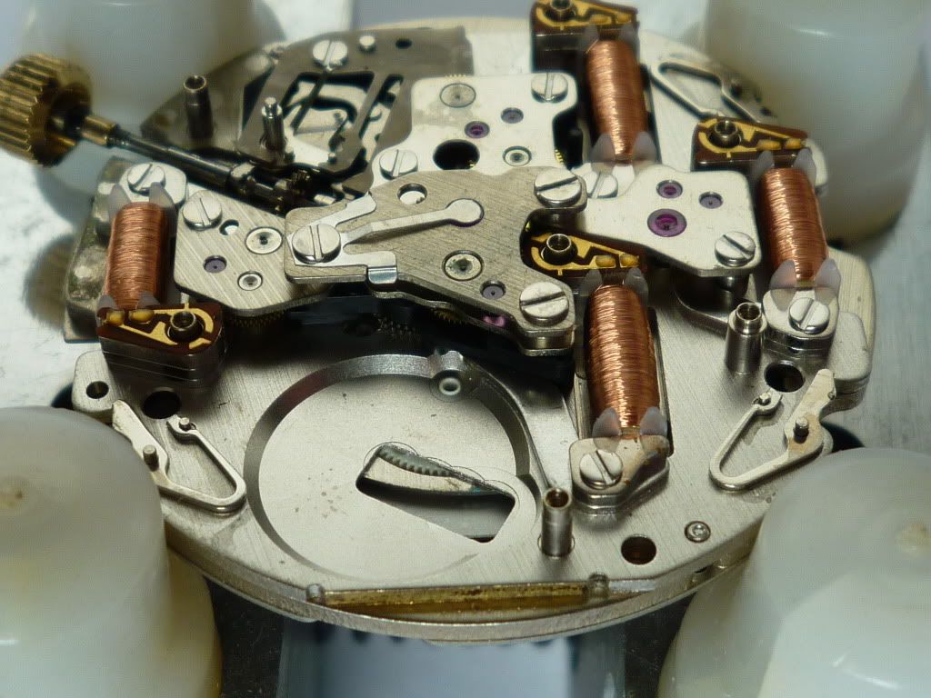

It's not just the fact that it's plastic (it can be moulded in either white or black), and that it is perilously thin in a couple of places ....
But also it's position relative to the battery (on the other side of the movement) which makes it potentially even more vulnerable.

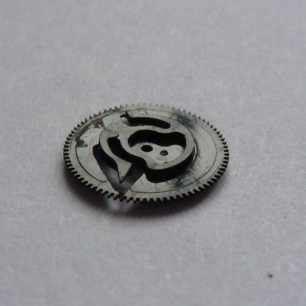

Here's one of my own photos showing the teeth of a white plastic day / date driving gear underneath the main-plate battery recess:
Here's another of Simon's photos (borrowed from another thread):
So any prolonged leakage of either fluid or fumes from an old run-down battery could also easily weaken it further, by making it brittle.

The Seiko manual states: If the setting of the calendar is made when the hands are pointing between 9 P.M. and 3 A.M. ....
Whenever I've observed them, the day / date changeover sequence of my 7A38's goes as follows:
11:00 PM Date wheel starts to move and is usually completed by 00:30 AM (the following day).
01:00 AM (previous) Day starts to move. By 01:30 AM changed to 'alternate' language; by 02:30 AM the Day changeover is complete.
I'm not entirely certain how it works (it's obviously not possible to see with the day and date display wheels in place), but those two thin lever arms on the plastic day / date driving wheel engage the teeth on their respective wheels during this change-over period. Thus common sense would tell you not to mess wiith the day / date settings, using the crown's quickset mechanism between these times.
But people do make that mistake. I've done it myself once - and only once. Never again. I've also bought two 7A38's where the seller had obviously broken the day / date driving wheel in this manner - most recently my NOS Orient J39908-70, the subject of this thread:

Funnily enough, at the weekend I had to refer to the Seiko 7A48A Technical manual - probably the first time I'd read it properly.
Top of the last page is this warning:
Yet no such warning appears in the 7A38A Technical manual, where it's really needed.
What makes this warning seem more pointless and misplaced is that the date driving gears in a 7A48 are metal - not plastic. :roll:

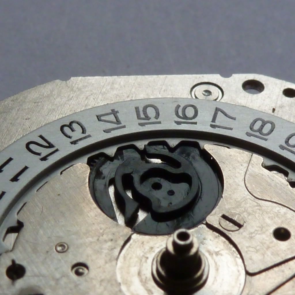

Here's an example of a damaged day/date driving wheel:
(the damage is at about 1:30pm)
November 25, 2013 at 4:15 PM Flag Quote & Reply

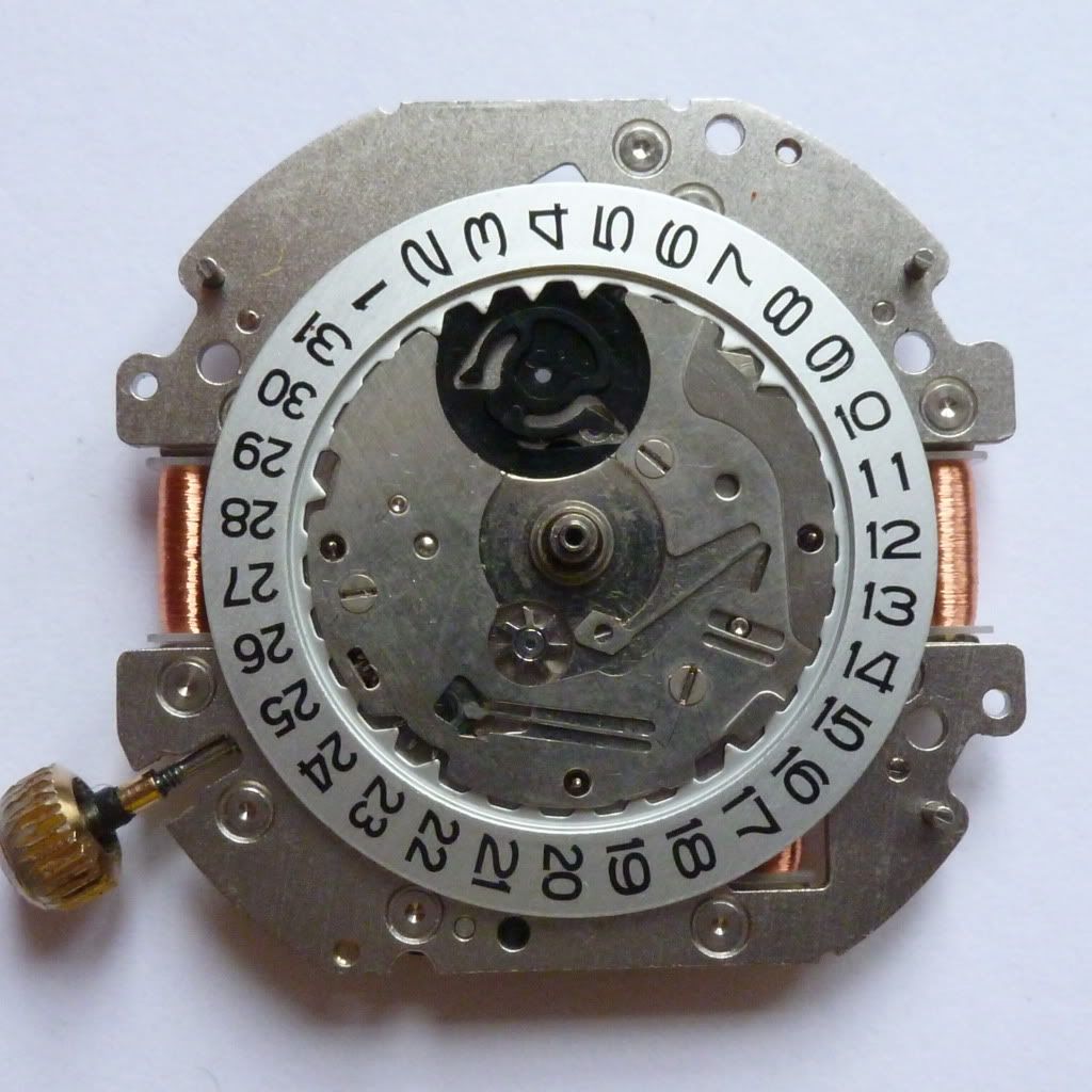

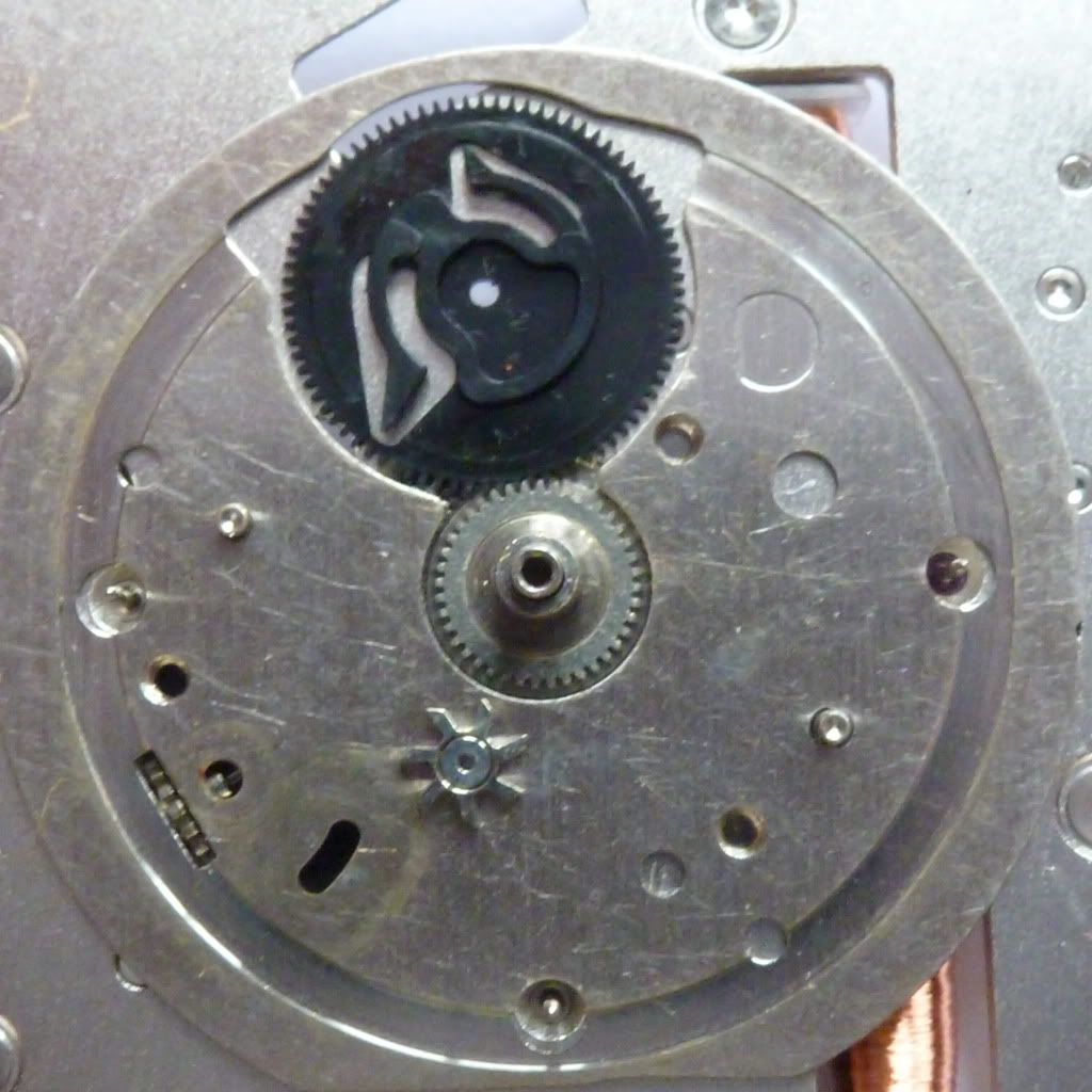

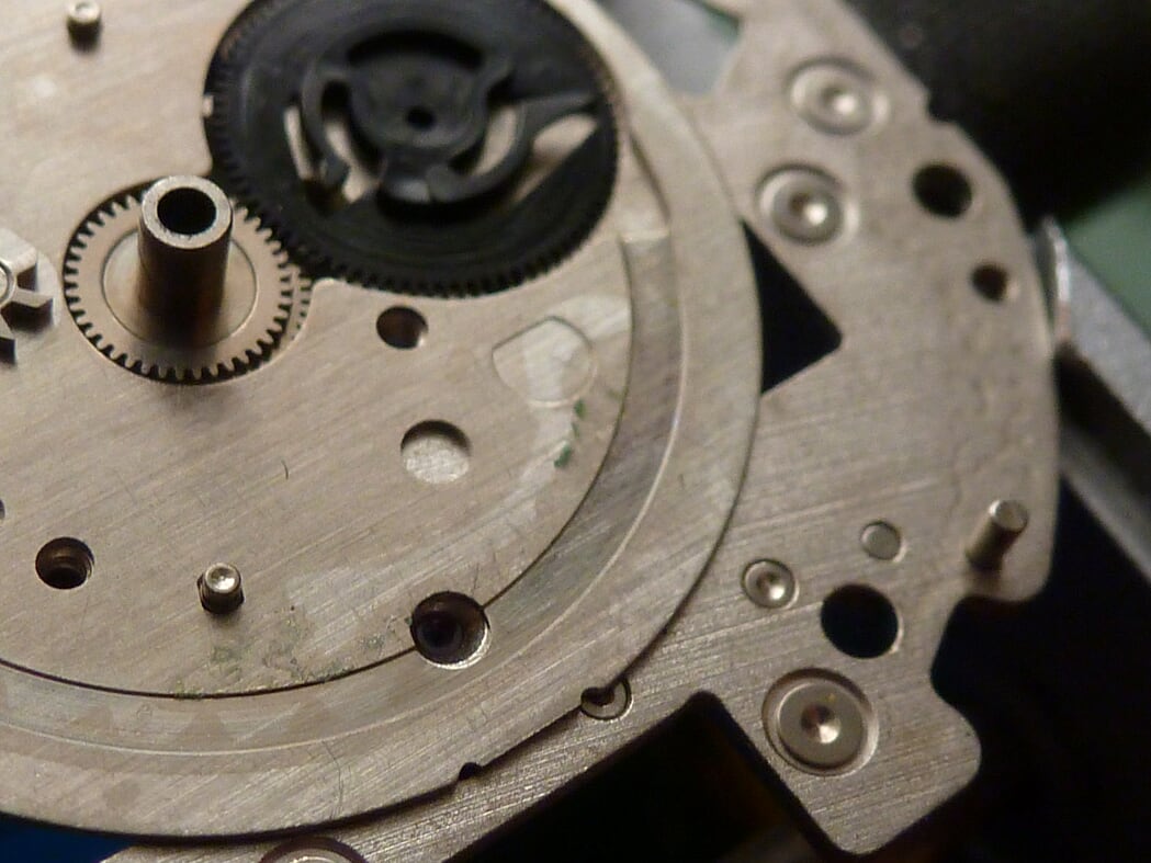

Herewith a brief study of the 7A38 date/day changeover mechanism.
I will exclude the quickset date/date setting mechanism (as they are independent).
In the very centre of the movement is the centre wheel and pinion - this is what the Minute hand is fitted to.
On the outer edge of the indented circle (at approx. 11pm) is a gear (the minute wheel) - this is driven by the centre wheel and pinion, and in turn this is what drives the hour wheel, fitted in the next picture.
You can see where the hour wheel teeth mesh with the teeth of the minute wheel. You can also see the black plastic wheel (the day & date driving wheel) - this is what drives the date dial and the day star with dial disk.
The above picture shows the calendar plate fitted (to hold the day & date driving wheel in place), the date jumper and the date dial.
The date jumper has a sprung 'finger' that engages the teeth of the date dial (in the above picture on the 5th).
The purpose of the date jumper is to ensue that the date dial advances by exactly 1 division (1 day) at a time.
Now we fit the date dial guard, held in place by three screws.
Then we can fit the day star with dial disk (held in place by the snap ring).
OK - so how does it work?

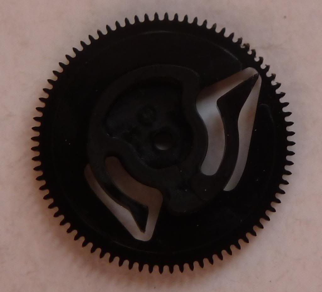

Let's look again at the plastic day & date driving wheel (spot the difference!!)
Other than the outer teeth, the obvious detail is in the two 'fingers' - of different lengths, and though not entirely obvious at different heights.
The 'date finger' at the bottom (in the above picture) drives the teeth of the date dial.
As the centre wheel and pinion rotates (as the movement runs), the hour wheel is driven. Thus the Minute hand moves, and so too the Hour hand - in sync with each other (as they are geared together).
As the hour wheel rotates, the day & date driving wheel rotates - in sync with each other (as they are geared together).
At a particular point, the 'finger' makes contact with the teeth of the date dial. This finger pushes the date dial around, advancing it from one tooth to the next, with the date jumper ensuring it aligns perfectly each time.
The 'day finger' opposite it is longer and is designed to pass over the teeth of the date dial and to engage with the day star, which is hidden on the underside of the dial disk,
As the hour wheel continues to rotate, the day & date driving wheel also rotates. The 'day finger' makes contact with the teeth of the day star. This finger pushes the dial disk around, advancing it from one tooth to the next, with the day jumper ensuring it aligns perfectly each time.
Hopefully the above makes sense. It's not helped by the name of the parts, which don't exactly roll off the tongue.
Remember that the Minute hand is press fitted onto the centre wheel pinion. And the Hour hand is press fitted onto the hour wheel.
A good watch maker will do his/her best to fit these hands so that they both align perfectly at 12pm, and where the movement has a date/day complication that the date changeover completes as close to 12pm as possible (it's quite fiddly so +/- 5 mins or so is quite acceptable).
A bad watchmaker or a careless tinkerer will often fit the hands so they don't align at 12pm, and the changeover can take place at any point. This is a very good (or bad?) sign that a watch has been badly serviced.

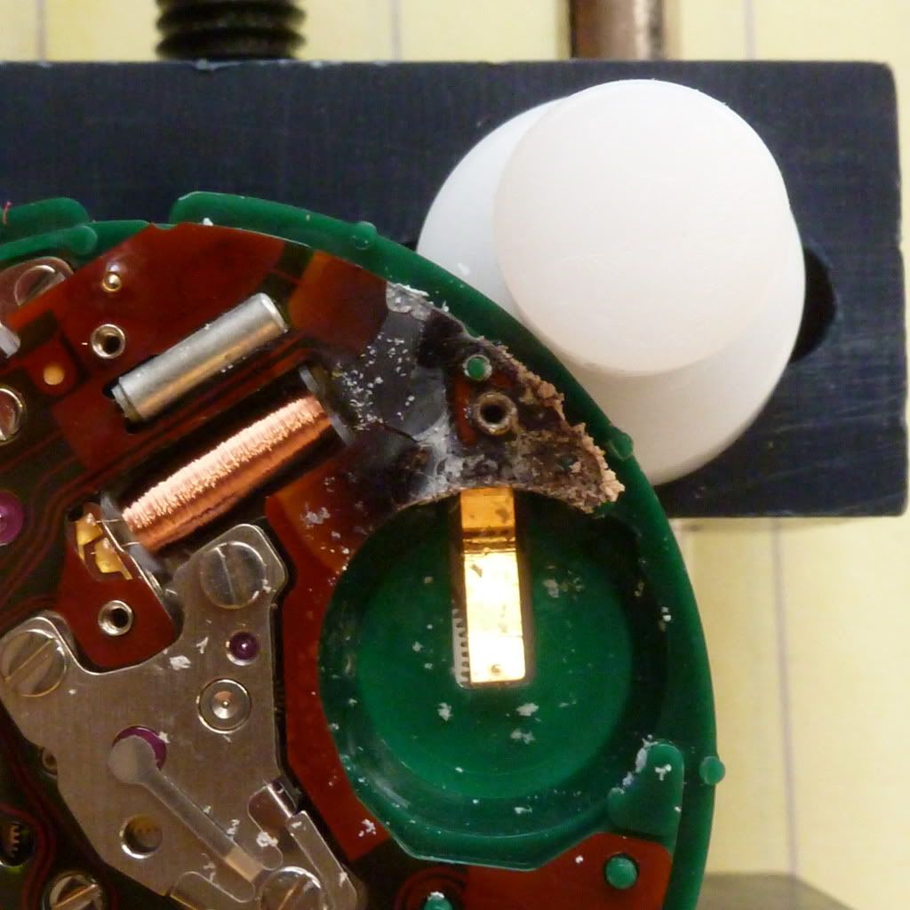

@ Rob. Per my earlier post, thinking it might provide a possible answer to your problem, I was hoping Simon would use the grotty 7A38-728B I'd sent him as an example. He finished servicing it yesterday. Turns out there was actually nothing wrong with the plastic day / date changeover wheel in my watch's movement.
The watch had suffered a minor battery leak and appears to have been given an amateurish enthusiastic over-oiling at some point. There was lots of sticky residue and battery sulphate deposits all over the movement, including the area of the day / date changeover mechanism, which was causing additional friction. For example:
