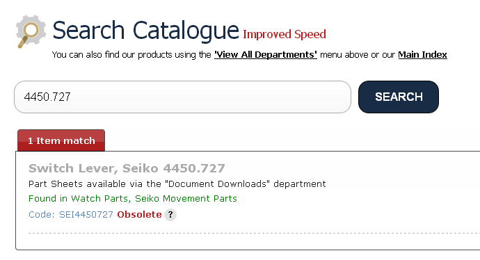

If you search on 4450.727 on Cousins' website now, you'll see this:
This is what shows (in my basket for the back-order for 5, that I'd subsequently created for myself):
Confirming what Seiko Oceania's database had been showing for some time:
So it look's like the supply (or at least what stock Seiko UK had left) has finally dried up.

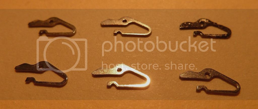

The pieces arrived. I was a bit uncertain, because the picture in the ebay listing was so bad, but they seem to be original parts. The upper three are the original ones from a 7A38-706A with damage due to battery leakage. The lower are the new ones. I will only replace the badly damaged one on the right. It did not break yet, but it has bended a bit and corrision is very bad. It think they are probably made from spring steel and then plated with something. Does anybody know what the silver coloured plating might be? Since I only have a tin plating bath available, I will maybe try to tin plate it. Maybe it becomes reusable in the future, but I think it will break pretty easily due to the corrosion. For the other movement parts I used vinegar essence and WD-40 to clean it. That actually worked quite well, especially the vinegar.
