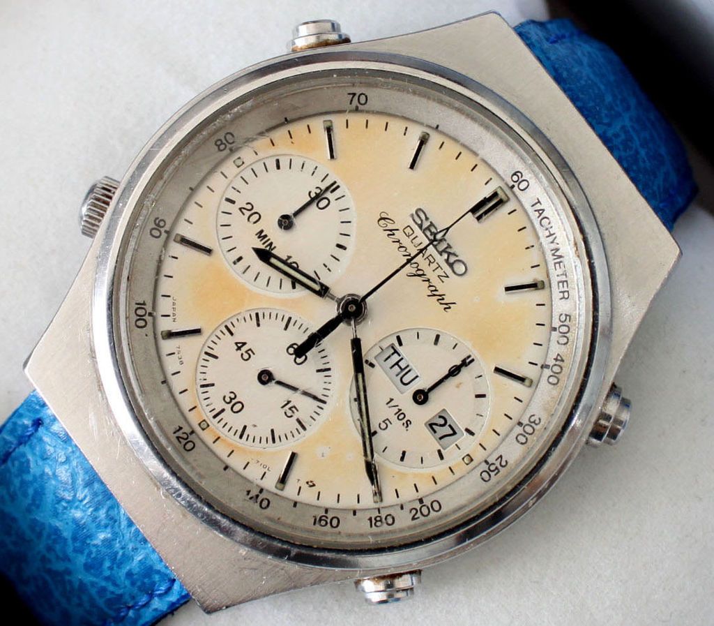

Have a good condition 7A38-7080 from circa 1984. Recently noticed some condensation on the inside of the glass which went after a few days but I now notice that parts of the dial (which is white) have started to yellow. Have got the back off and the movement out of the case. The yellowing is not too bad but is there an easy way to remove it? Checking the internet I saw one suggestion to use diluted ammonia which seems drastic.

Firstly we need to clear up the confusion over the model number of your watch. The 7A38-7080 is a black chrome coated 'Diver' with an all black dial. If the watch you're referring to is the one shown in your profile photo / avatar, that's a stainless 7A38-7060 (SAA015J). Check the case-back and you'll see it's stamped 7A38-7060. The dial part number printed at the bottom is 7A38 708L (actually p/n 7A38708LXS17 in full), which is maybe what is confusing you.
Yellowing / staining of the silvery white 708L dial is less common. However you'll often see it on the 710L dial used in the stainless 7A38-7190 and stainless 7A38-7280/9. There's a particularly bad example of it on eBay at the moment, offered by a Romanian seller:
http://www.ebay.co.uk/itm/321860651441
He describes it as: rare Seiko 7a38 quartz chronograph men's watch nice yellowish dial day date 1/10:roll:
As you've correctly surmised this yellowing is caused by moisture ingress. Problem is that the yellowing is very likely happening under the dial lacquer. Have a read of this thread about a similar coloured 702L dial in a stainless 7A28-7020.

I would be VERY hesitant about using any strong chemical (even in diluted form) - particularly Ammonia to clean your dial. :/

You are absolutely correct. I re-checked the case back and it is indeed 7A38-7060 (I clearly need to get reading glasses!). The staining is not too bad - I don't think a casual observer would notice so might just leave it rather than risk doing more damage. I'm going to focus on making sure there is no more moisture ingress. Will renew the seals on the pushers and the back case and put some oil at the oil points. Is there anything else that you would suggest?

If you're going to renew the pusher O-rings, don't forget to do the crown post seal, as well. Plus of course a smidgen of Seiko silicone grease on the O-ring seals and case-back gasket.
Unlikely you'll find a replacement dial; it's long since been discontinued, but you could try quoting that part number to Seiko UK on the off-chance they might have one.
