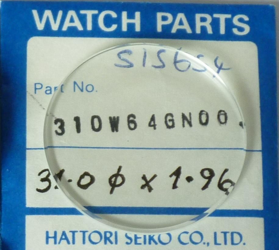

1) Not all the original Seiko crystals used in Seiko 7As are unobtainable. Most of the conventional flat round ones are no longer available, but it’s a relatively easy matter to find replacement ‘generic’ crystals – be it Borels, Cousins or Sternkreuz or Superparts. Fortunately, there are still dwindling supplies of some original Seiko domed crystals around, which can be found with a little effort.
31.0mm and 32.0mm diameter by 1.5mm thick flat round just happen to be two of the most commonly used crystals in ‘regular’ 7A38s.
The 31mm Ø x 1.5mm is used in the -702x, -7190, -726x, -727x, -728x case models (although Seiko have 2 different part numbers allocated). The 32mm Ø x 1.5mm is used in the -706x case models. But there are plenty of other sizes used in different case styles ranging in 0.5mm increments from 27.5mm Ø (domed), right up to the 32.5mm Ø x 1.5mm flat used on your 7A38-7000. They also vary in thickness from under 1.5mm to nearly 3.00mm thick on some of the ‘Divers’. Some have polished upper bevel edges; some don’t.
I haven’t counted them up, but there are probably at least 20 different part number crystals used across the whole 7Axx range - The first 3 digits of a Seiko crystal part number tell you its overall diameter, but the remaining characters are seemingly insignificant (other than to identify it specifically, or sometimes as a press or tension fit crystal).

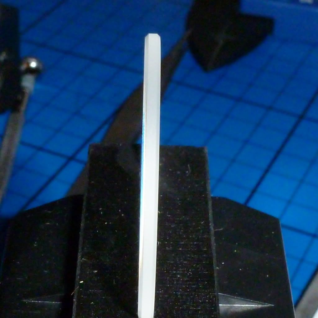

Here’s a 31.0mm Ø crystal used in the recently discussed 7A38-6020. It’s over 2.5mm thick and double domed with a bevelled edge !

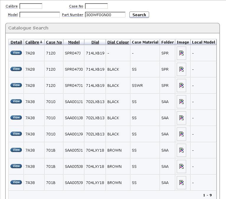

There is an almost complete definitive list of 'what fits what' available online, and it belongs to Seiko - their Oceania database search.
If you plan to start doing work on your own watches, then you need to get used to using this (sometimes with a little interpolation, too):
http://service.seiko.com.au/pls/seiko/f?p=104:20:7036103027065222:Go:NO:RP::  - see more useful stuff on our 'Other Links' page.

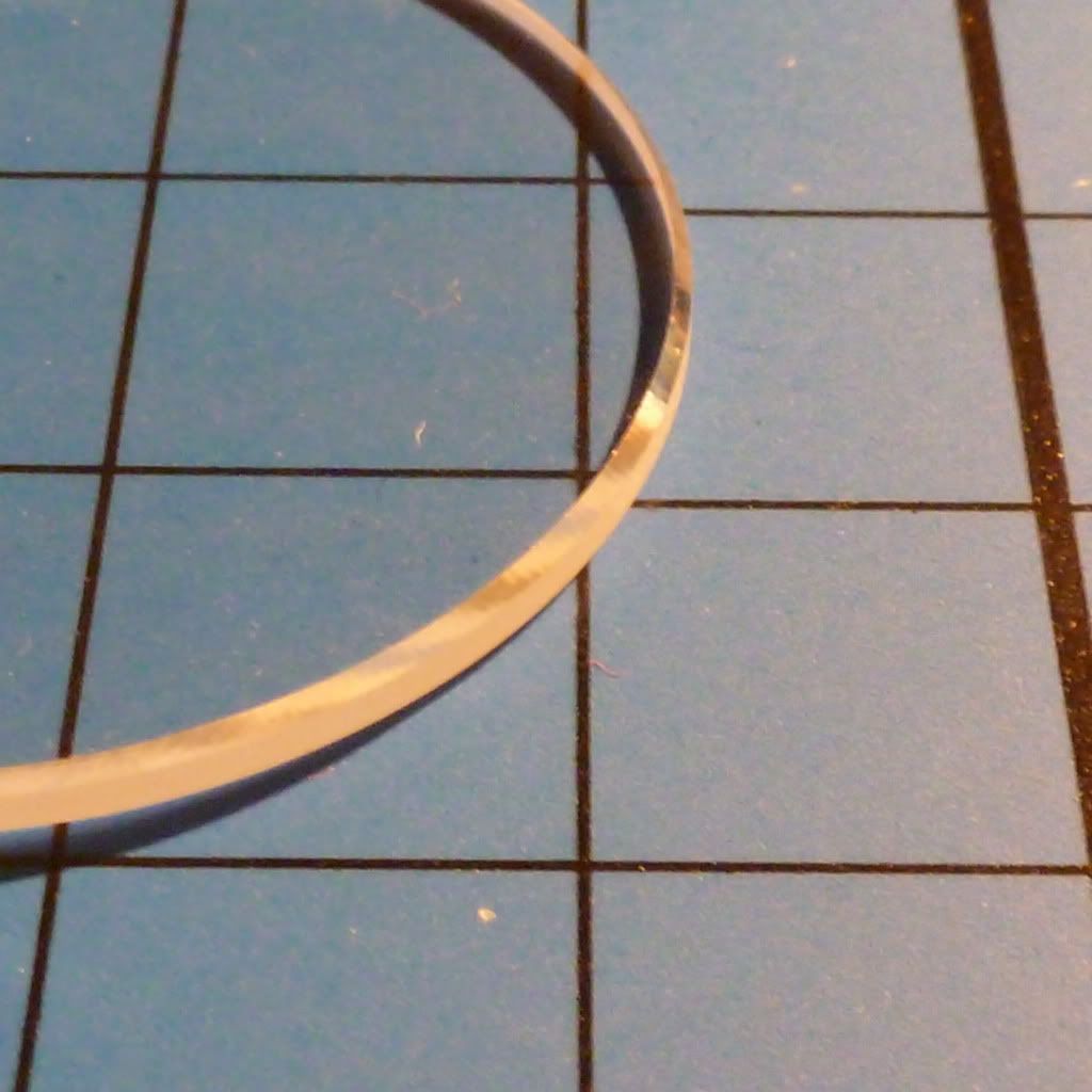

2). In a ideal world, when fitting a new crystal, one would think it good practice to fit a new crystal gasket. However, when they were originally fitted in the factory, the crystals were almost certainly pressed in by hydraulic (or pneumatic) machines. Crystal gaskets are made of a hard nylon (usually black, but sometimes clear on certain models) and the tolerances are extremely tight. When you pop out an old crystal, it’s likely you’ll see a slight step in it, where it has been partially compressed (for some of its depth) by the old crystal. In theory, it should be possible to fit a new gasket with your replacement crystal. In practice it’s damned nigh impossible to press them home properly, without considerable physical effort - that’s if you can even persuade the crystal to ‘start’ squarely.
If you examine an original Seiko crystal – either the old one you have pressed out (or if you’re fortunate to have a NOS genuine Seiko replacement), apart from possibly having a polished decorative top bevelled edge, you will notice that it also has another ‘lead in’ bevelled edge ground on the underside. It is this ‘lead in’ edge which facilitated fitting the crystal, in the factory when the watches were made. It is this ‘lead in’ bevel which leaves the tell-tale ‘step’ indentation in the original gasket, where it doesn’t compress the gasket for its entire depth. As you know, I am an advocate for fitting Sternkreuz toughened glass replacement crystals, particularly their MSM range. I can’t say that they are any harder (in terms of scratch resistance) than Seiko Hardlex, but they certainly are stronger, particularly if you give them ‘a bit of welly’ pressing them back in. I have never once broken a Sternkreuz crystal pressing it back in, but I have shattered the odd Seiko Hardlex (pressing them out), and cracked a few Cousins ‘cheapies’ pressing them in, in my early days.
The other thing I like about using Sternkreuz MSM crystals, is that they usually have NO ‘lead in’ chamfered edge. The edges of the crystal are ground straight and parallel. That may make them harder to 'seat squarely' initially - and to press in, but it also gives you a ‘second bite’ at the lower part of the original Seiko crystal gasket. Get my drift ? Sternkreuz also produce I section crystal gaskets in white Nylon. Their dimensions and tolerances are not necessarily exactly the same as the original Seiko, but I have successfully used them on a couple of white dialed watches. Here’s one of my two 7A38-7280 stainless 'daily beaters', which I alternate, fitted with a Sternkreuz white nylon crystal gasket in place of the original Seiko black nylon gasket. Sternkreuz MSM310 crystal naturally, too.
Incidentally, Sternkreuz crystals are a fraction the price of original Seiko crystals (if you could find them). Cousins are even cheaper.

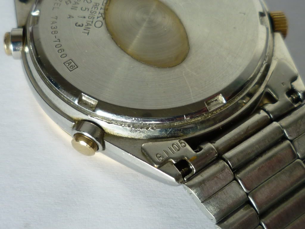

Case-back gaskets deserve a topic in their own right, but seeing as you asked the 'simplistic' question in the same thread ....
Here's my not so over-simplified reply (3):
No they’re not (all the same) Simon. But, despite the differing case designs and sizes, because Seiko 7Axx’s all use exactly the same (31.8mm) inside diameter threaded case-back flange – there are actually only two. I’m not sure where you think you may have seen a press fit case-back on a Seiko 7A, but as far as I’m aware, they all use screw-down case-backs. The only (non-Seiko) 7A38 I have encountered which uses a press-fit case-back is the inappropriately-named Junghans High Tech, which uses a red Sanfil gasket:
I have come across a few instances where ignorant fools have obviously tried (and failed) to lever off screw-down case-backs on 7A38’s, as if they were a press-fit, presumably in an attempt to replace their own batteries, using a variety of sharp and blunt instruments. Here’s one example of such butchery, which almost ruined what was previously an otherwise pristine case-back:
But I digress.
There are two part numbers called up in the 7Axx bills of material / parts lists: FH3180B0A and FH3181B01. ‘FH’ stands for Flat Hard (rubber), and ‘318’ is the inside diameter. They are of slightly different section, in that the ‘0B0A has a slightly larger outside diameter (to match the width of the case-back flange), and also appears to be marginally thinner. As a general rule (and again something of an over-simplification), the ‘0B0A is used on Sports 100 models with a ‘Double Wave’ case-back and the ‘1B01 is used on watches with plain case-backs. There are odd exceptions to this rule, such as the 7A38-6080’s and -6090s, which are designated SQ100, but have plain case-backs, and hence used the ‘0B0A gasket to help achieve their 10 Bar WR rating.
I use new OEM Seiko gaskets on watches I intend to wear regularly, as proper sealing of the case-back joint is critical to prevent moisture ingress (from perspiration). But I have used various other substitute replacement gaskets in the past, including Labanda’s (Australia) p/n FE318BA12 (the same original Seiko p/n was used on the 6M15, 6M25 and H201) and Cousins’ cheaper flat round rubber gaskets, which are made in softer rubber – with some success. Both when re-using old gaskets (which I sometimes do, on watches destined only to sit in one of my various collection boxes), or when fitting a new gasket, I always give both gasket and the case-back threads a light smear of Seiko Silicone grease.
Not only does it assist with waterproofing, but also helps the gasket to slide around the flange, as the case-back is tightened.

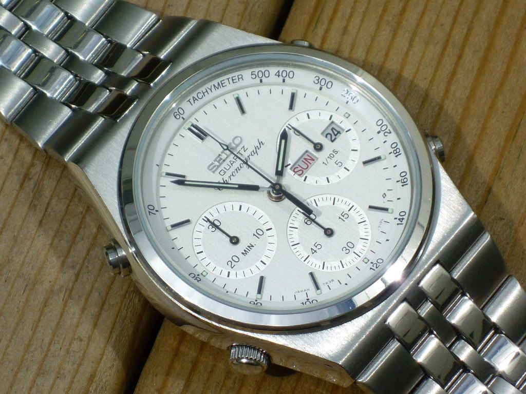

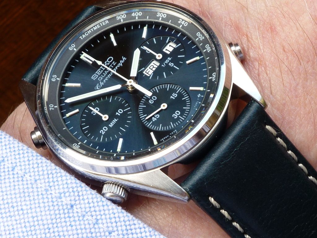

Forgive me for churning out the same two old photos of my stainless 7A38-706As, but they serve as a useful illustration:
The upper photo shows my almost mint 7A38-706A on the bracelet, still with an unmarked original Seiko p/n 320W40GN00 crystal.
The photo below is my 'beater' 7A38-706A on TSS Watchworx strap, which I've fitted with a Sternkreuz MSM320 replacement crystal.
In the upper photo, you can clearly see the polished decorative bevel edge of the original Seiko crystal, which the Sternkreuz lacks.
My preference for using Sternkreuz MSM crystals over Cousins cheaper equivalents is a 'historical' thing.
In the early days of changing my own crystals, I used Cousins' own brand crystals - on the recommendation of DaveS, as it happens.
However, I found when 'giving them a bit of welly', pressing them in those last few fractions of a millimeter, they would sometimes crack.
I remember Dave telling me he'd even had them 'ping' up to 24 hours after fitting - as the stress put on the glass slowly relieved itself !
As I wrote above, I've never yet managed to break a Sternkreuz crystal in fitting one as a replacement - they're as tough as old boots.
Their only 'downside' (if you can call it that), is that without exception, their standard MSM range come with plain parallel ground sides -
and no polished decorative beveled edge in the sizes / applications where you might need one, such as the 7A38-706x case range.
It's purely a question of aesthetics and 'correct appearance' - it depends if you're a stickler for originality or just want a(ny) new glass.

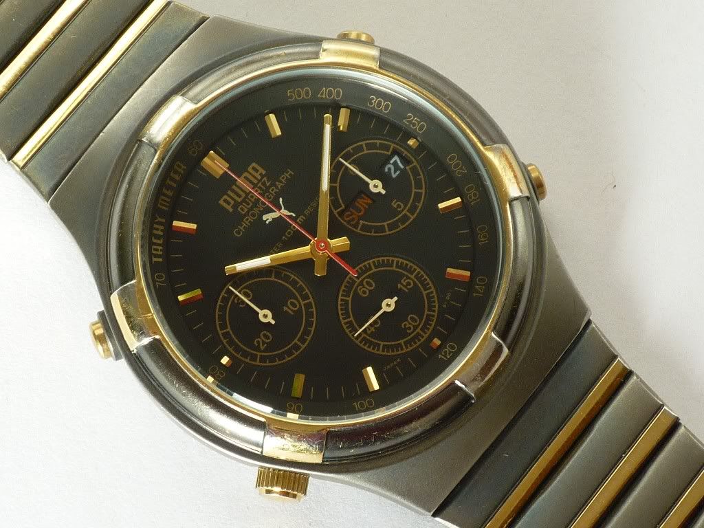

Here's my Puma Y19201-70 '7A38', which I fitted with a replacement Cousins 31.0mm Ø x 2.5mm crystal - effectively upside down.
The exposed polished bevel edge of the crystal may be slightly smaller than that of the original, but it's a lot closer than that of say the Sternkreuz XMF310.853 which I tried ordering, only to find that their polished decorative beveled edge was disproportionately huge !
Which means, presuming that Cousins aren't sitting on a mountain of old stock, and have since received newer supplies of their p/n F150CMH320 with the polished 'lead in' bevel, you could try ordering one, and in effect, fit them 'upside down', to get the polished beveled edge, such as one might want on a 7A38-706x or the equivalent 7A28-702x. Haven't tried it myself yet - but I may do soon. ;)

Whereas it is nominally intended as a replacement for Seiko p/n 300W08GN00 (wherever that may have been used) ....
I have found it to be not only an almost perfect replacement for Seiko p/n 300WD6GN00 used in the dressy 7A38-6080's:
for Seiko p/n 300WF0GN00, used on the 7A38-7010, 7A38-701A (not found on Seiko's database) and 7A38-701B 'Vulcan',
but also for the military buff's favourite 7A28-7120 RAF Gen 1, which from what I've seen of various examples on eBay, often seen to come fitted with a multitude of cheap nondescript and distinctly non-beveled edged replacement crystals, whereas they should have:
Last but not least, I've also identified Sternkreuz XMF300.860 as a suitable replacement for Seiko p/n 300WC2HN01 used on 7T59s:

If you did, you may notice that it has gone a little cloudy in the middle, where the stresses of being pressed had relieved themselves.
That one was probably VERY close to going pop ! :D
PS - Beginners mistake #1 - always measure not only the diameter, but also the thickness of the replacement crystal before fitting.

Here is what an XMF320.927 looks like:
May 10, 2012 at 4:28 PM Flag Quote & Reply
They arrived in this morning's post and first one fitted, to my beater 7A38-706A.
Unless you knew what you were looking for, the Sternkreuz p/n XMF320.927 crystal, with its polished bevel edge doesn't look that different from their plain flat p/n MSM320 crystal. Like the colours of the dial, it's hard to capture the extra 'sparkle' it gives the watch.
But I know it's there. 8) Well worth persevering, and the wait. :)

Does anyone know what the thickness of the original 310W64GN00 is ?
This crystal is used for both 7A28-7040 and 7A38-7070.
I would like to replace the crystal in my 7A28-7040. I know I should press it out and measure it, but I thought it would be faster and easier to ask this question here before I do anything.
As it is a "diver" model I guess the Sternkreuz MSM310 crystal is too thin, the crystal is probably 2.5-2.85mm thick ?
I realised that the original crystal is still available at Cousins, but for £11.30??? No, thanks! :P

Last time I measured one, Arpad - it was 1.96mm - or near enough 2mm. ;)
