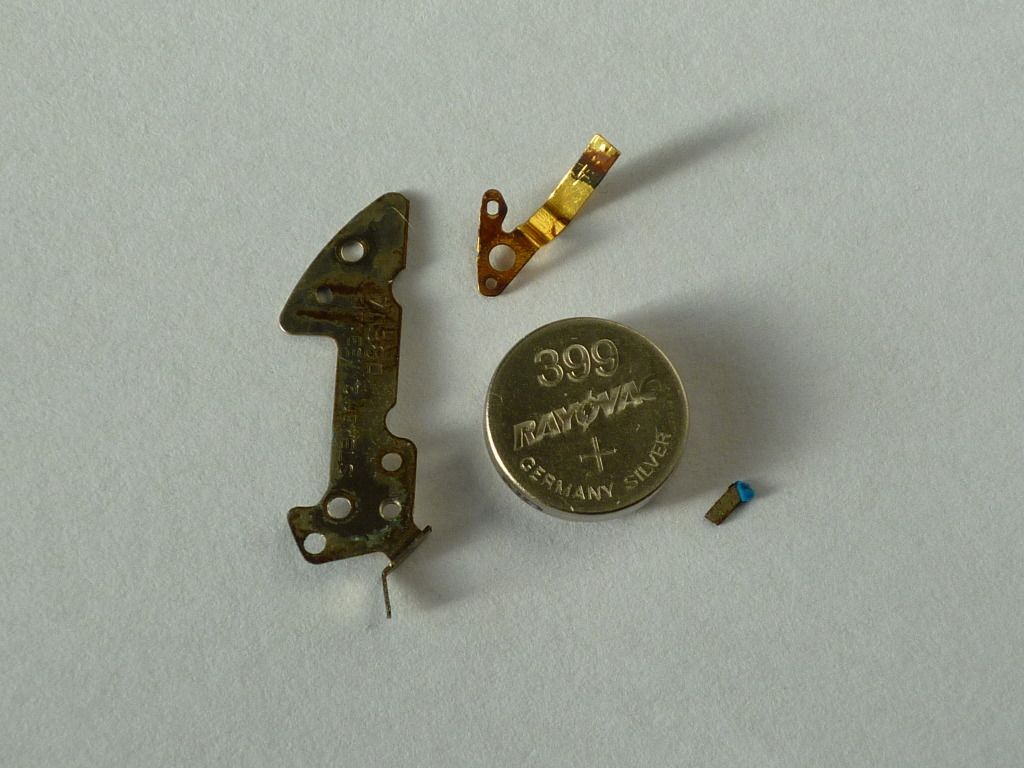

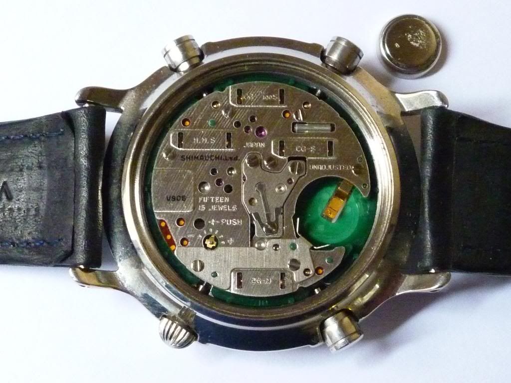

When I undid the case-back I found an undersized # 399 had been fitted, but worse still that the positive battery plate was corroded.
I gingerly pried the old battery out, and one of the positive battery plate 'fingers' literally fell off. It had been eaten right through. :o
Inside the battery well was a pool of liquid, and the gold-plated negative battery terminal had been badly tarnished.
I didn't bother to take any photos at this point  - my first priority was getting this mess cleaned up quicky.
It involved removing the main back-plate which was slightly 'fogged', and the circuit board - to clean the area of the negative contact,
and of course to enable me to replace the badly tarnished negative terminal, which at this stage looks distinctly beyond cleaning up !
Here's the movement after my very hasty clean-up operation, still in the original watch case (both terminals and battery now replaced):
Here's the ruined terminals I removed, and the battery (which was still working, remember) that caused the damage:

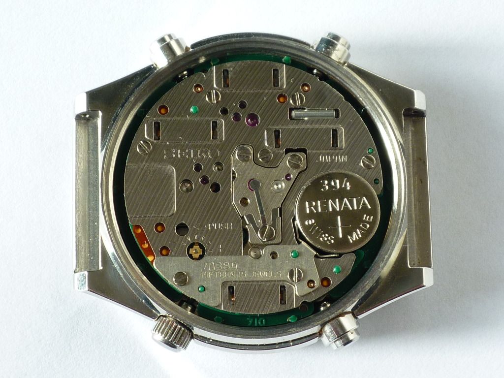

Now, up until fairly recently I'd always been an advocate for using Maxell SR936SW (# 394) Silver Oxide batteries, and nothing else.
But earlier this year, they appear to have stopped producing them (as such), and now offer a 'Mercury-Free' equivalent (same p/n) -
which just happen to be double the price ! So I've switched to using Renata #394 Silver Oxide (@ the same price Maxell used to be).

Gentlemen ....
I give you the working RAYOVAC (made in Germany) battery which came so close to destroying the insides of one of my 7A38's.
You have been warned.

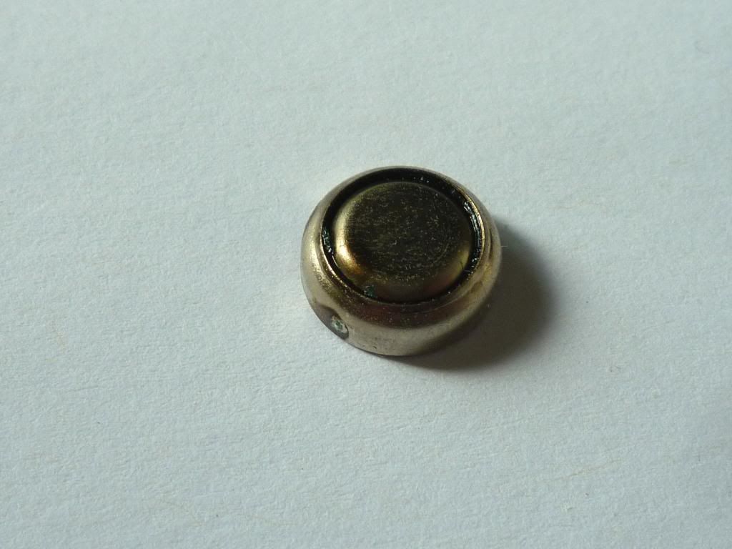

Gentlemen ....

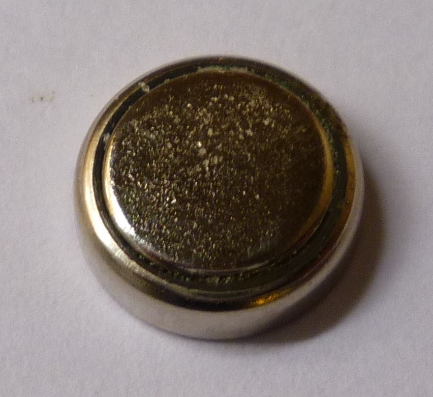

I came across another leaking Rayovac battery this morning and I'm rapidly coming to the conclusion these are far worse than any of the cheap Chinese made brands I've encountered, like Camelion or Tianqiu, to name but two.
This time it was a correct size # 394, made in USA, as opposed to a # 399 made in Germany.
It was completely dead - in the dressy Yema N8YM53 I'd bought on eBay France last week.
Please excuse the less than stellar photos. My priority was to get the mess cleaned up, before it spread any further. When I popped the old battery out, my first action, before grabbing my camera, was to mop out the pool of clear liquid that I found in the battery well.
It was all over the gold plated negative terminal too. Note once again the bright blue suphate deposits (as in the previous 7A38-7190).

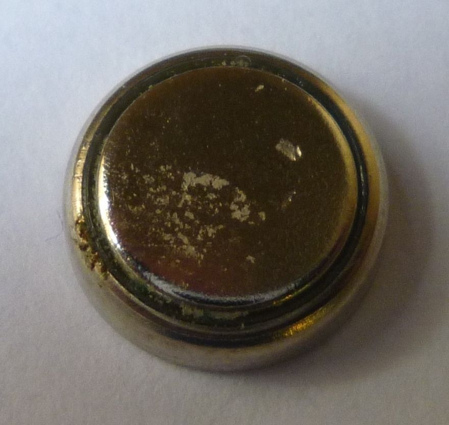

Another warning - about FAKE batteries ! :o
Needless to say I normally keep a good supply of Renata # 394 batteries in stock. I buy them in packs of 10's from Cousins UK.
I also keep a 10 pack of # 399's to cover the odd 7T32, etc. and also of 371's and 377's for my little collection of intel watches.
Last week a friend at work asked me to change the battery in his Rado. Got home, popped the back off and it needed a # 315. :roll:
I wasn't about to order a 10 pack from Cousins, just for a one-off. So I went looking on eBay.
Found a UK seller who was selling them singly, at what I thought was a reasonable price:
http://www.ebay.co.uk/itm/261404700538
It arrived yesterday. It was posted second class in just a normal manila envelope, so the 'bubble' part of the battery packaging  was all crumpled up. But through it I could see that there was a strange 'blister-like' flaw on the top polished surface of the cell. The printing on the top of the package looks very sub-standard, as if it has been rubber-stamped. I think I've just been sold a FAKE Renata battery. :mad:
Such things definitely exist: http://www.google.co.uk/search?q=fake+renata+batteries&oq
Case opened in eBay's resolution center, awaiting seller's response. If I get time, I'll post some photos later. Caveat Emptor !!
May 3, 2014 at 4:39 AM Flag Quote & Reply
A little later than planned, here's a couple of Q&D photos. Note the difference in printing and lack of expiry date on the # 315 packet:
Because the bubble part of the packaging had been crushed, it was almost impossible to capture that flaw on the battery's surface:
I can't cut open the packet to get a clear shot of the battery itself, because the seller has now requested I return it for a full refund. :roll:
Apparently Sony batteries are another brand that are commonly faked: http://www.microbattery.com/counterfeit-sony-watch-batteries
Not wishing to give Sony undeserved bad press, but the worst example of damage to a movement by an old run-down leaking battery, that I've ever personally encountered - in an Orient J39908-70 '7A38', was caused by a Sony battery. Perhaps that one was a fake. :/

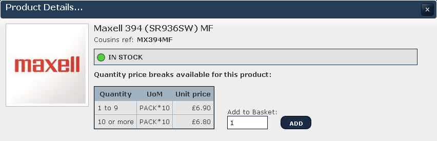

Seiko7A38 at November 18, 2012 at 7:39 AM
Now, up until fairly recently I'd always been an advocate for using Maxell SR936SW (# 394) Silver Oxide batteries, and nothing else. But earlier this year, they appear to have stopped producing them (as such), and now offer a 'Mercury-Free' equivalent (same p/n) - which just happen to be double the price ! So I've switched to using Renata #394 Silver Oxide (@ the same price Maxell used to be).
In hindsight, I remember that I'd written in glowing praise of Maxell batteries in a thread on the RLT forum, two years earlier:
http://www.thewatchforum.co.uk/index.php?showtopic=59398
Happy 5th Anniversary – Seiko 7A38 And Maxell #394 !
Checking my Cousins invoice folder, at that time, in late 2010, a 10-pack of (pre-M/F) Maxell #394 batteries cost £4.80 + VAT.
When Maxell introduced their 'Mercury Free' versions the price doubled to a Tenner ! :o .... Hence why I switched to Renata.
I suspect that little 'marketing ploy' cost them in terms of lost sales, because they've since bought their price down somewhat:
